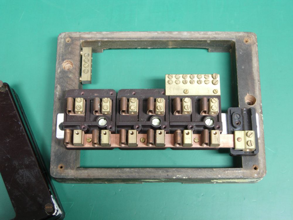

WYLEX TRADITIONAL REWIREABLE FUSEBOX.
Inside of the extenso board.

The earth bar looks a little lacking.
Probably assumes 2 of the circuits are for lighting or for 2-pin sockets, which wouldn't be earthed in The Good Old Days.
Yes, that could well have been the case. I might also have expected one larger hole in the earth block for a decent sized 'incoming earth connection' (as with the neutral block).
Kind Regards, John
they didn't have large earth cables in those days.
I removed an ancient BILL unit with similar earth terminals, and the incoming earth has been split between two terminals!
Also lacking in the number of earth terminals and wires had just be wrapped around other bare earth wires in some cases.
Go back a bit further and there a quite a few old installs where the main earth and the cpcs are twisted together outside the fusebox and all soldered together.
