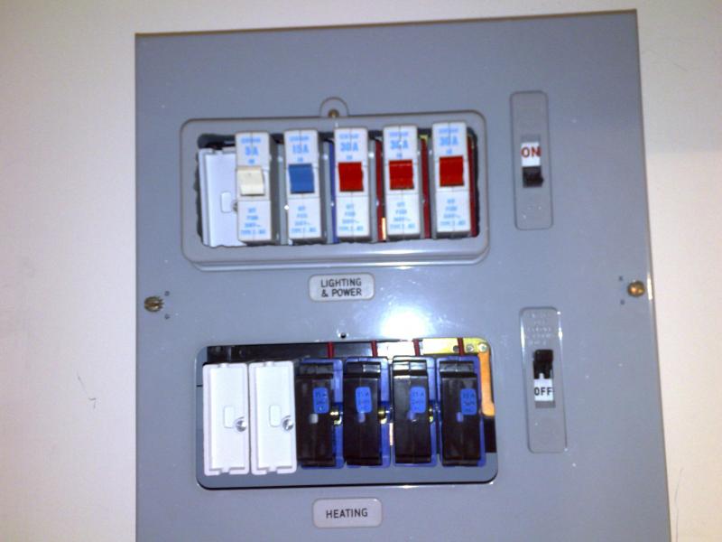

Hi all,
I have been reading many threads here recently so decided to join to ask my troubling question.
I have recently bought a 2 bedroom flat and am refurbishing it throughout. I am not good with electrics and so i got my fuse box checked as i am installing a new kitchen.
According to the electrician, i need a fuse box upgrade if i am install a new oven and hob in the kitchen. Also i would need an extra dedicated wire running from the new fuse box to the kitchen.
Here is the picture of what i have currently..
Ok the breakdown as to how the fuses work in the flat from testing.
the 5A - Lights throughout
the 15A - No idea - guessing the hot water immersion heater.
30A - Dedicated Oven and Hob
30A - Sockets ring covering entire kitchen and living room
30A - Sockets ring covering rest of the flat ( 2 rooms + 2 bathrooms)
15A x 4 - 3 Storage heaters and may be hot water immersion heater.
Now from the above setup do you think i need to upgrade it to a newer high capacity CU to cater for newer appliances?
I am only replacing like for like appliances in the kitchen i.e oven, hob, extractor hood etc.
Plus i will be changing some ceiling lights to down spotlights with dimmers.. would this trip the 5A one?
Personally i dont think i need to upgrade but i am not sure about current legislations etc.
Please advice me..

Interesting what your electrician wants to run another circuit into the kitchen, did he/she tell you what it was for? It is best practice to have the kitchen socket outlets on a dedicated circuit, but by no means essensial.
What it could be is if your new oven and/or hob is going to be of a much higher wattage than the old one.
He/she has his/her reasons, if you don't understand why, a decent spark will have no problems explaining their reasoning.
Regarding a fuseboard / CU upgrade, I'd also advise a replacement, the gap around the fuse carriers (especially the heating circuits) is a bit wide for comfort (fingers, foreign conductive objects etc :rolleyes: ) and you don't appear to have any RCD protection on any circuits, and it is highly advisable from a safety perspective to have RCD protection.
Adding another circuit to that board would in theory be possible, but it would be a struggle to obtain the parts for a circa late 70's early 80's board. Most electricians would have reservations signing off a new circuit that did not have any RCD protection present.
Hope that answers all your questions!
H'mmm a double-decker metalclad Wylex Standard?
this would have been considered up-to-date in 1970, but things have moved on.
By the look of it you have electrical storage heating, is it on an off-peak tariff?
It was not designed for loads above 30A per circuit, and I can't see provision for a large Cooker circuit, so for that reason alone, I agree you need to upgrade, and this sounds like a good time to do it. You will need a certificate which your electrician can issue if he is a member of a self-Certification scheme (ask him which one, and what trade name he is registered under)
It is also impractical to add RCD protection to your old CU, which is nowadays considered essential for your safety.
Yes it is on off peak economy 7.

What sort of CU do you recommend? i.e how many ways and A's

I'd reccomend a similar 'double decker' but with split-load RCD at the top and RCD main switch at the bottom.
Most major quality CU manufacturers do them, but they are expensive and in some cases fitting 2 seperate CU's can work out cheaper, it a shame really, but its that old supply-demand chestnut!
Theres a fair few ways to tackle this and yuor electrician will no doubt have his favourite.
Crabtree and MEM are very good makes, but your electrician will have his favourites.
MK are not as good as they used to be
Wylex is fair.
Get as many ways as you can think of circuits that you have now or might want in future, plus plenty of spare ones (a large CU is not much more expensive than a small one, as you are just paying for an empty plastic box and some fresh air)
If you are not short of a shilling you might consider RCBOs which give individual RCD protection for each circuit. However they cost about £25 extra per circuit :(
If your off-peak supply comes on only at night, it is easier to have a separate CU for it (dual tariff CUs are available, but they are not common and are rather expensive). However if all your power goes onto cheap rate at night, one large CU will be OK but you will need some kind of timer for the storage heaters. (I could tell becaise the heaters are on a separate bank, which is typical of a dual-tariff CU. Also you have a bank of 15A fuses, which is typical for night storage heaters)

MEM make double-deckers but they are expensive and probably special order.
Well the Sparky who recommended an upgrade said it would cost me £1200 including the extra ring in the kitchen and parts.
