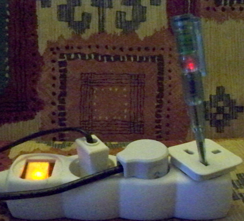

Yes, the problem is there is no perfect way, but the simple neon screwdriver and the two wire tested can fail to show when there is power, so I use both, test with two wire tester but also use neon screwdriver.

much maligned volt-stick, which relies upon the field around a live conductor and needs neither your body, nor an earth, nor neutral.
If it is detecting a voltage "field" then it does need you body as a reference potential. If the person using the volt_stick is standing close to a Live cable then the volt-stick's reference voltage. ( the potential on the person's body ) may be close to Live voltage. Hence the volt-stick will give a false reading of no voltage when testing a conductor that is Live and may indicate Live when touching an Earthed item
If it is detecting a magnetic field from a conductor then there has to be current flowing in that conductor to create that magnetic field. The conductor could be at Live voltage but without current flowing, the volt-stick will not give a Live indication.
Bernard - try it yourself. Put a volt-stick supported near a live cable with no current flowing through it, preferably one which includes a tone, walk away and see if the tone continues. It works with my Flukes..
They use capacitive coupling from live cable to the volt stick. I would guess the other pole is the air surrounding the stick.
