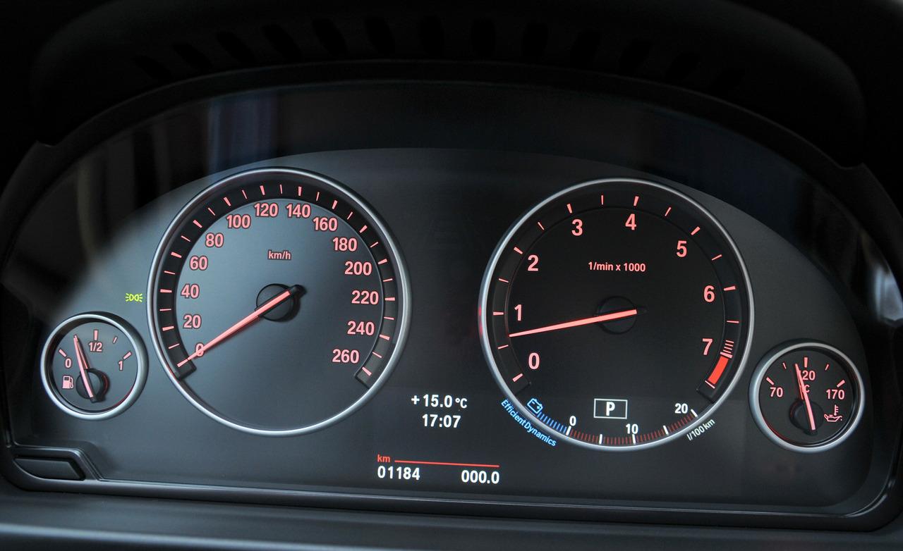

If your BMW is one of the "F" models, the gauge will be an oil temperature gauge not coolant. Oil temperature takes far longer to increase than coolant so I suspect it will get up to temperature before the gauge indicates. I have no idea why BMW chose to do this, but there is a small legend on the gauge to show it is oil temp....
No it is definitely a water temperature gauge.
2011-bmw-535i-instrument-cluster-photo-394303-s-1280x782.jpg.91ccecc87b953fa5ccc02d34d2443646.jpg
These are both F10 (5 Series) and F30 clusters and both are oil temperature gauges. I can only assume yours must be an optional spec model, digital dash or similar? I know that my F30 (320d with B47 engine) reaches about 80 degrees coolant temperature (using Carly OBD) before the oil temp on the gauge has crept much above the 50 degrees. A friends F32 with the same engine does the same. Both will run at around 90 degrees coolant (but 70-100 oil temp) once on a run however cold it is....
