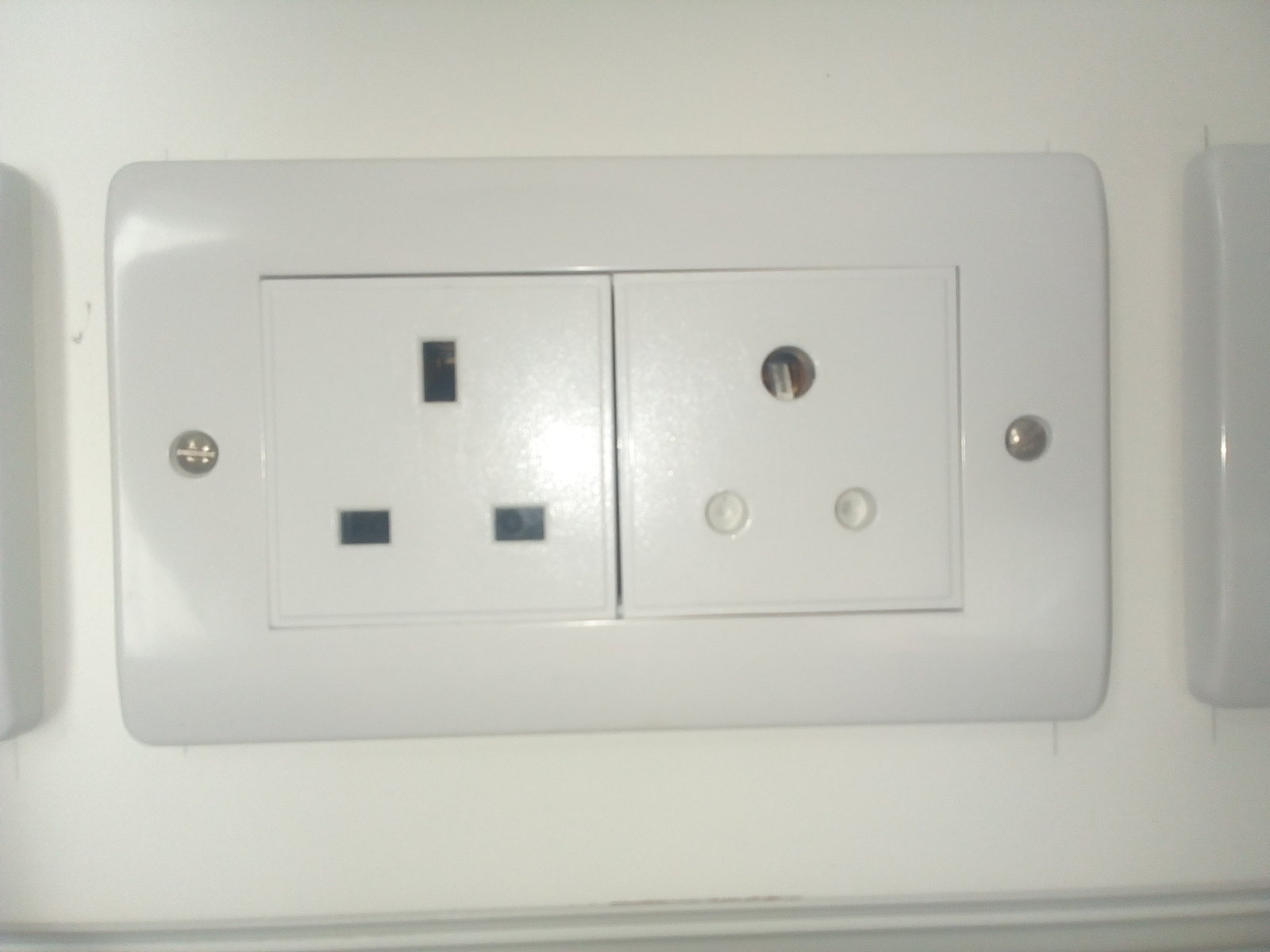

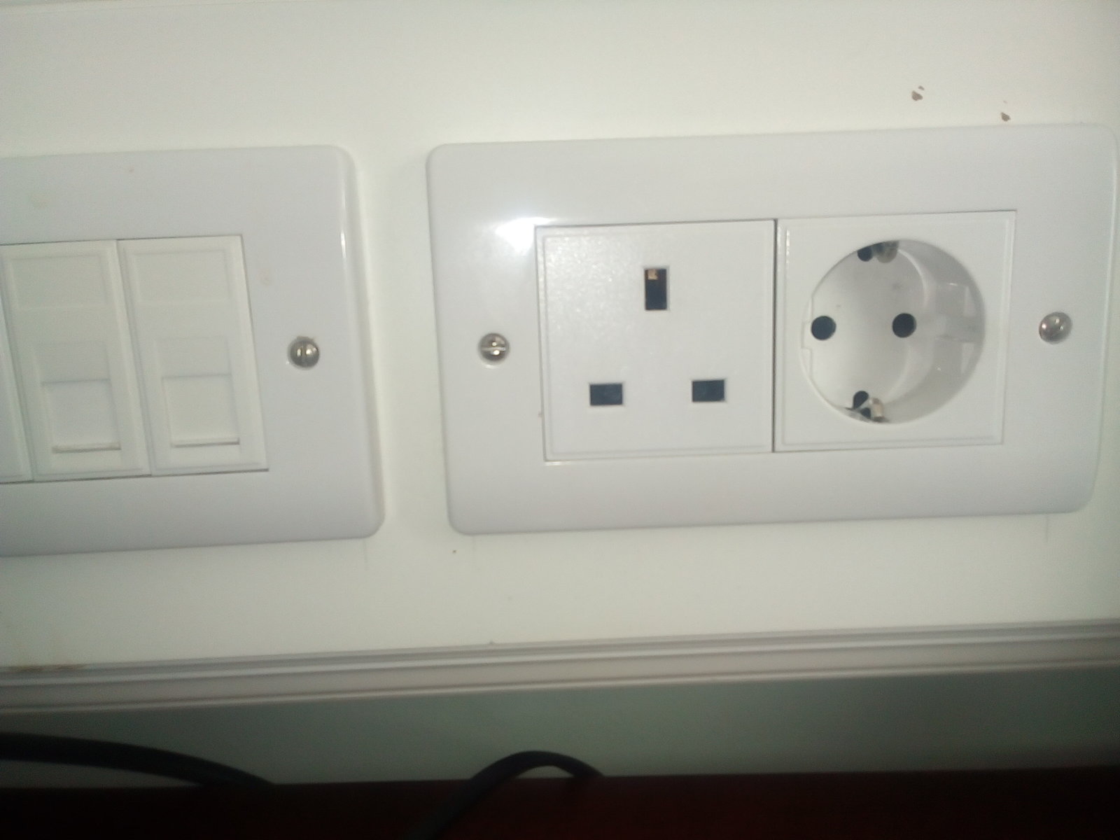

A quick search shows that Euromodule sockets are also available - so possible to have 2 sockets on a double faceplate.
Right on cue I found the attached in a hotel where it seems very confused, various combinations of Euromodules on a 16A circuit.
To add to the confusion there are also 5A sockets controlled by switches for lighting.
I can understand the Schukos, handy for visitors from continental Europe and presumablly cuts down on the use of dodgy travel adapters. The 5A BS546 does seem rather strange though unless they get a lot of visitors from india or something.
On a different note I presume 15A BS546 is too big to fit on a euro module.
Seems I was wrong, scolmore do make a 15A Euro module.
The 5A BS546 does seem rather strange though ...
Lights ? Probably for bedside lights or something like that - allows free-standing lights, switched by wall or bedhead switches, but users can plug the hair drier into a lighting circuit.
There are 3 plates making 3x13A, 2xshuko & 1x5A for power on a single pole MCB, plus 4 single plates with 5A sockets for the lighting controlled by a total of 4 switches for the main lights and 2 for bedside lights on a 3A mcb.
Plus one further permanent 13A socket on a 6A MCB (Sorry Winston) for the fridge.
This was in Gibralta.
