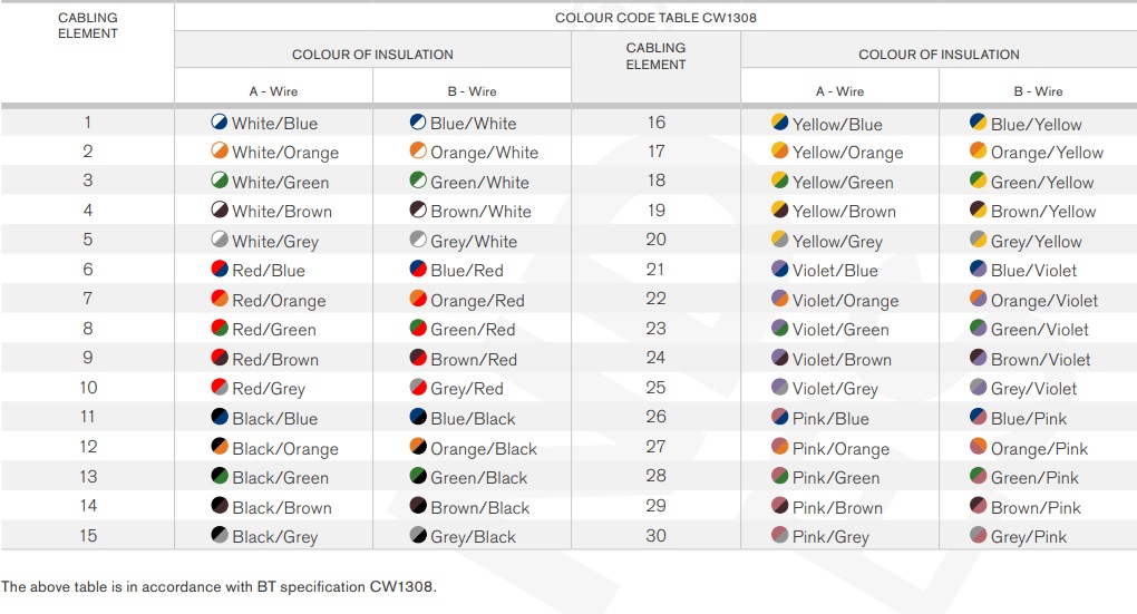

What bout signal cable? (Alarm cable) 4 core, 6, core, 8 core, 12 core and 20 core? wow, some colour choices?
I did once buy a roll of 12 core but never 20 core!
