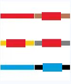

The trouble was/is, too many people wouldn't accept that the harmonised colours were in no way whatsoever linked to the old colours.
But they are totally and inextricably linked
Surely that is what SUNRAY is doing.
In a 3ph installation everyone would expect any mixture of new and old colours of a 3ph circuit to look like this:
But in that same installation EFL is advocating mixing the colours within a single phase circuit like this:
All I see there is confusion and hazard, I've been there a few times.

You only have to compare the structure of 3 core+E cable, to realise the colours should go:
Red - brown
Yellow - black
Bare earth - bare earth
Blue - grey.
