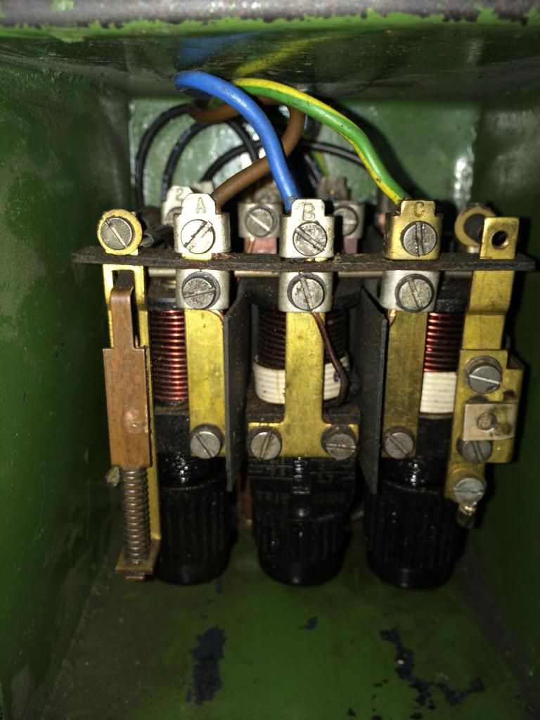

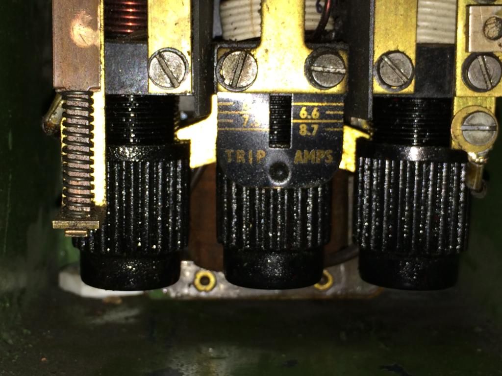

With the power OFF its worth looking inside the starter, there may be overloads and simply set too low for the moter

With overload set to auto reset and also set too low it would allow the motor to kick then nothing until it auto reset.
However it was tested before it was delivered to you and was OK.
So what could be different with your supply and the refurbish firms supply? If the supply it was tested on had a large volt drop and yours does not then yes you could get this situation.
This however seems unlikely but maybe the machine was tested and then the starter fitted and some one forgot to set the overload?
The only thing therefore I can think of is the overload is not set to the correct setting for the motor.

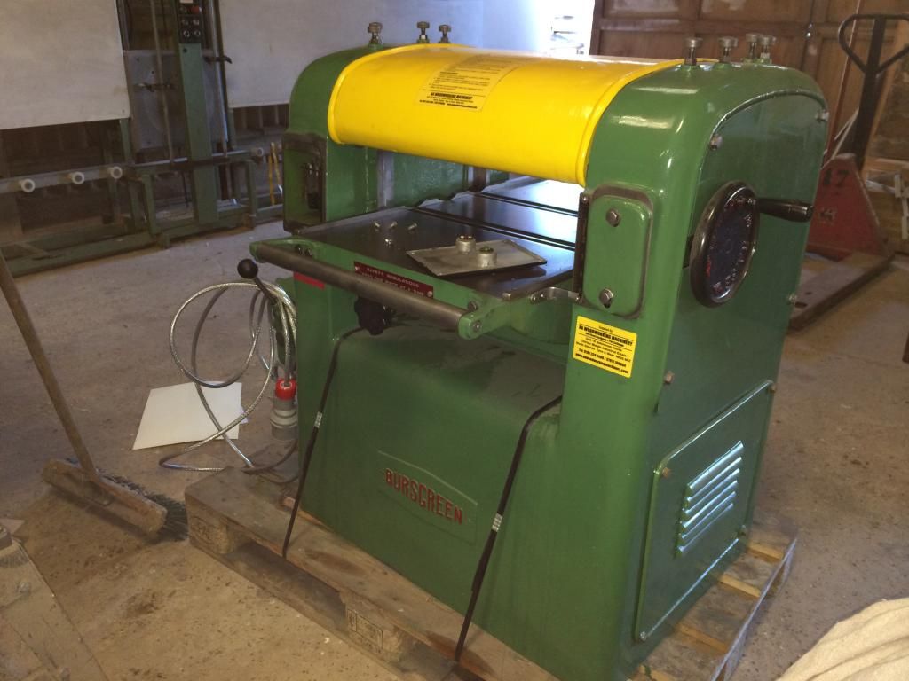

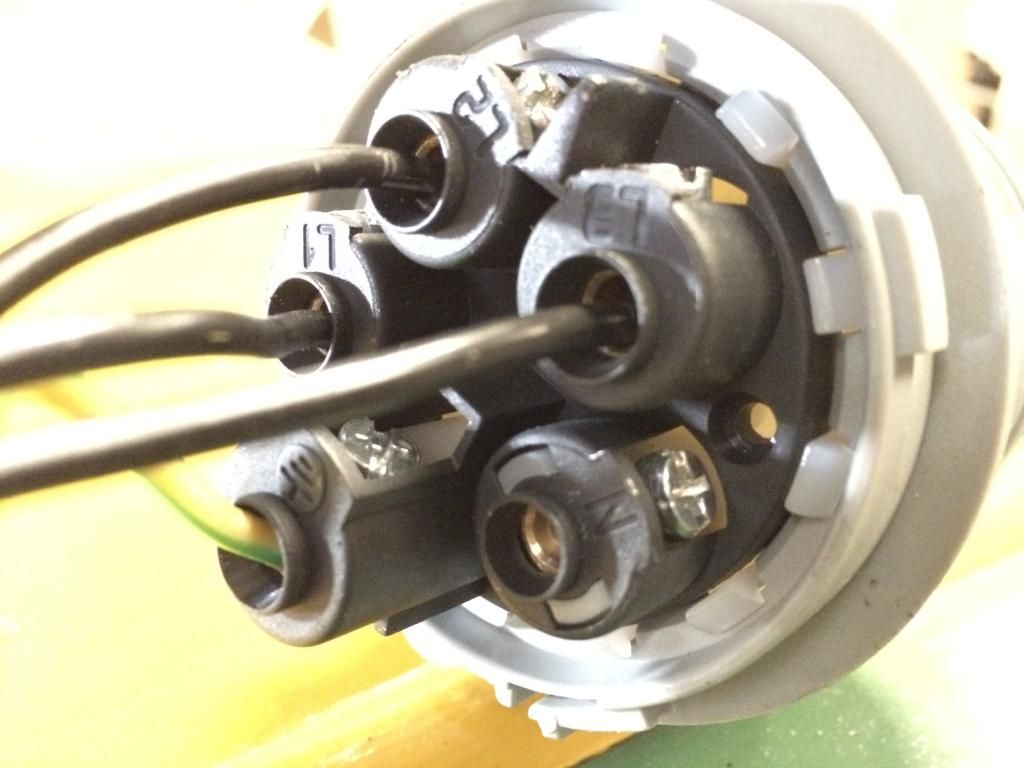

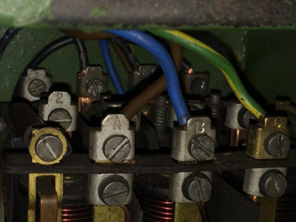

I have not had the electrician look yet, but i thought these photos may help explain what i have.
