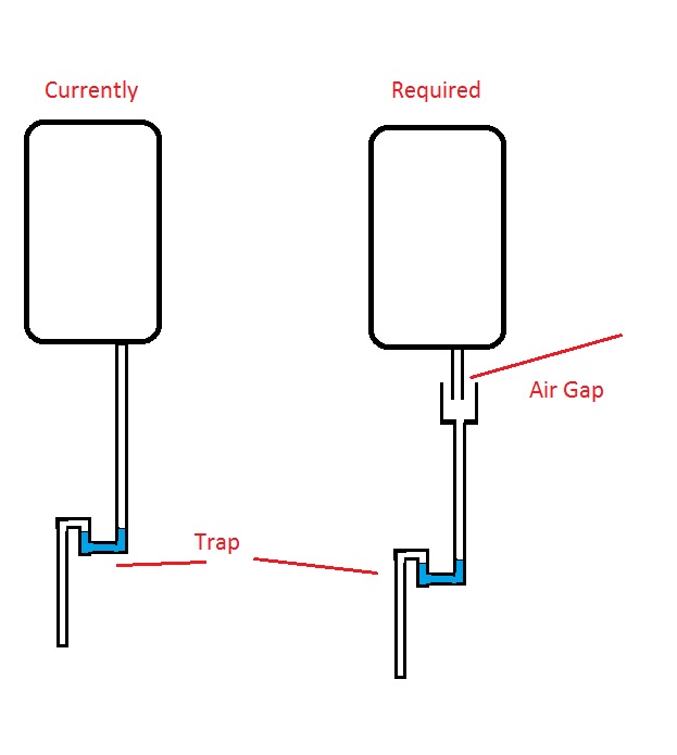

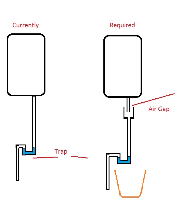

that condensate pipe should have an air gap if it is terminating straight into another trap, without it, it will cause problems with draining.

and yes what dean says is right, thats "Double trapping" as there is a trap in the boiler, so a sealed condensate pipe from boiler to another trap can cause problems with backed up water

Also - this "double trapping" - what will I need to have it fixed? can you please tell me in laymans terms? i will get it fixed it asap.

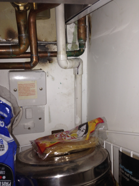

here is the picture of condense pipe coming out of the boiler. the design is similar to what you have portrayed as 'current'. im not familiar with plumbing diagram legend. the current deisgn you have is better than what the actual one is. in your current representation, incoming water has to travel that tiny bit more and therefore will have more gravitational opposition..
can i assume this is the place where he messed up? I could locate an industry standard document http://www.centralheating.co.uk/sys...ATE_DRAINAGE_PIPE_INSTALLATION_Final_2011.pdf
he calls himself an experienced installer and didnt know this?
