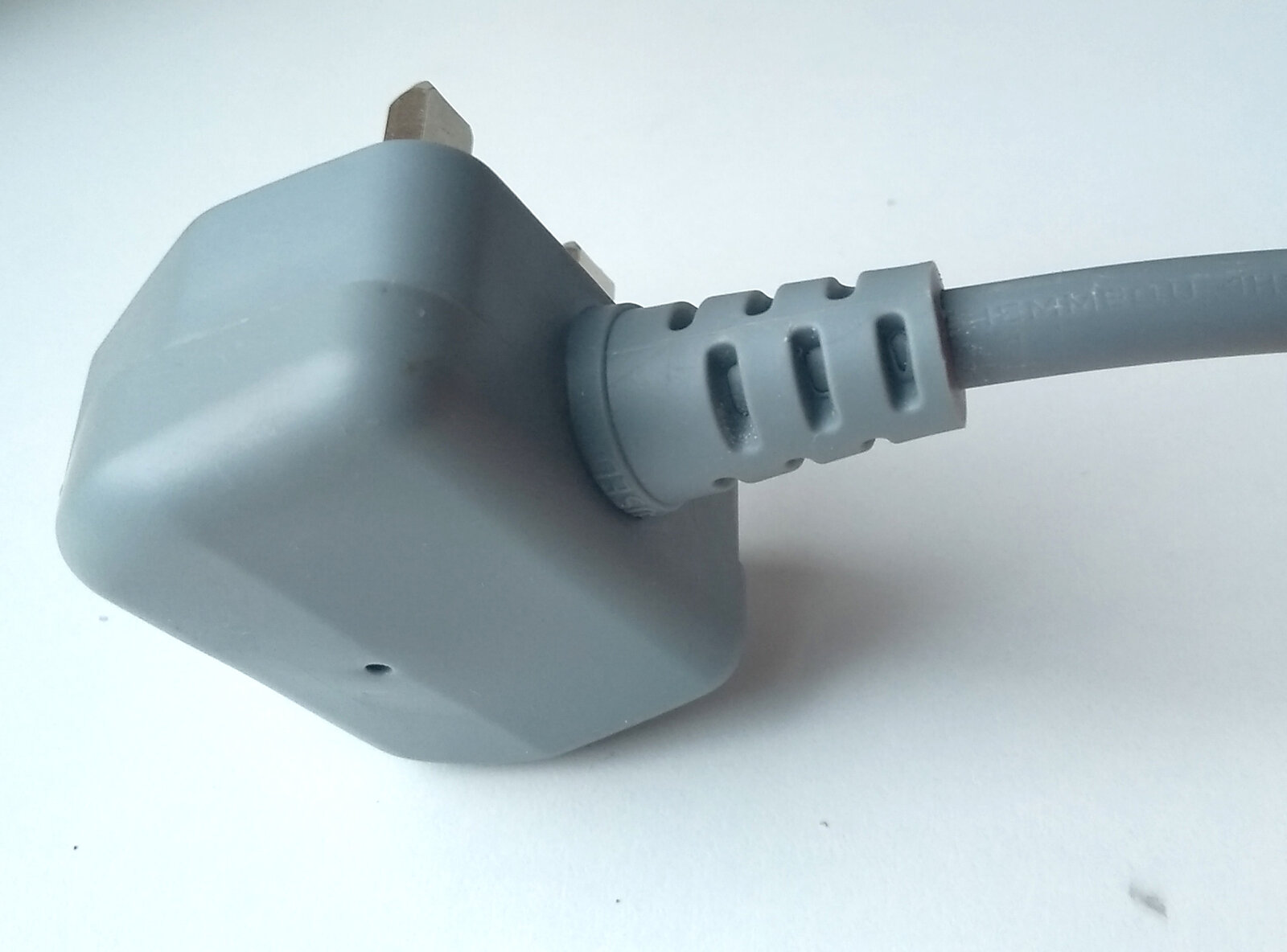

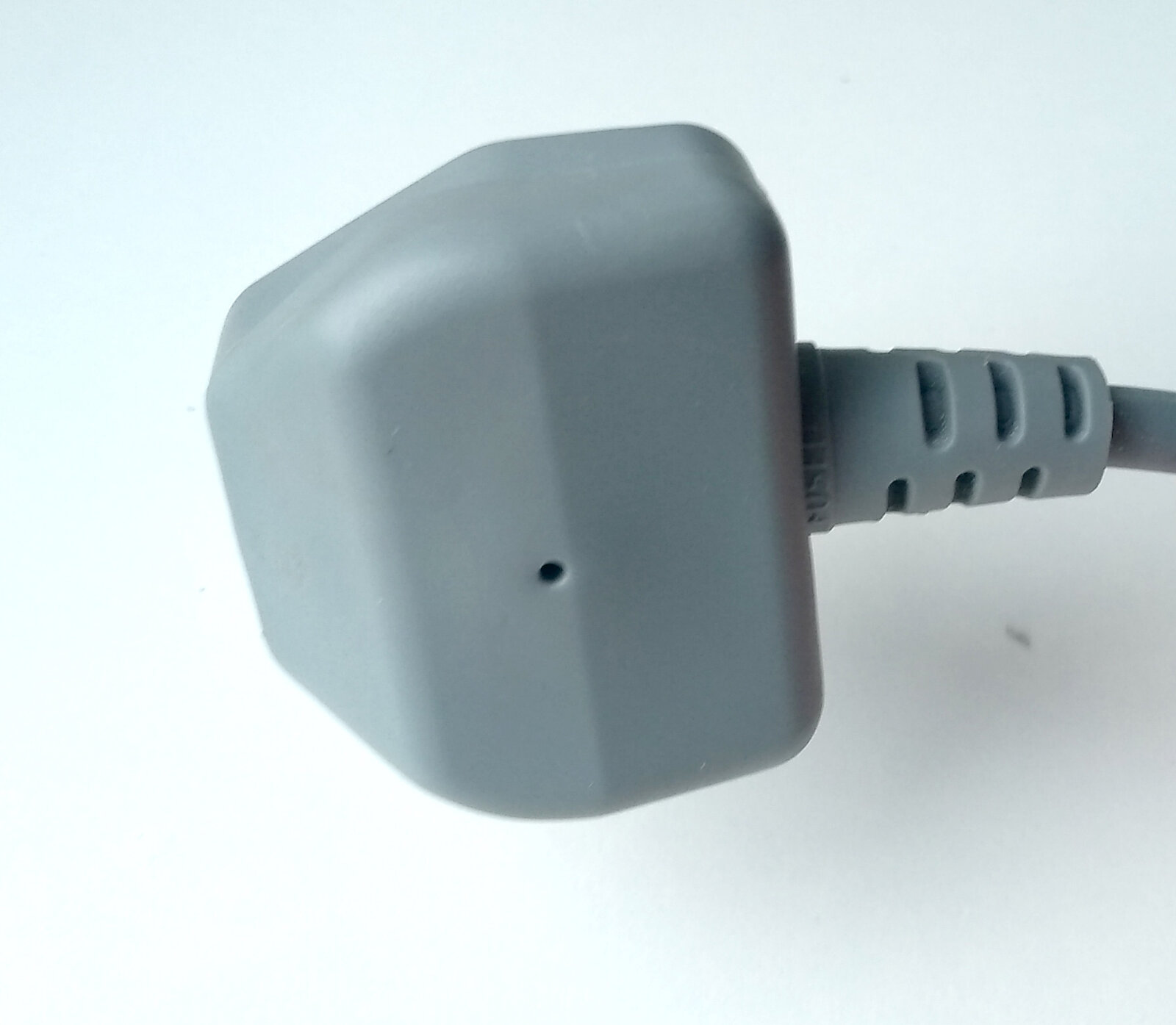

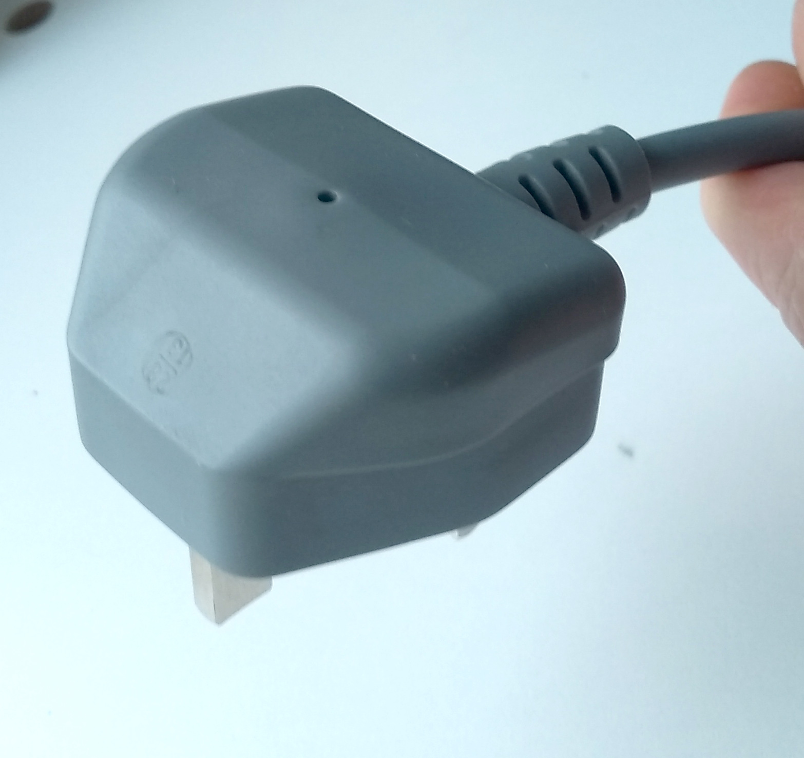

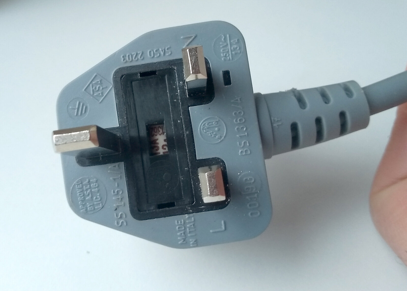

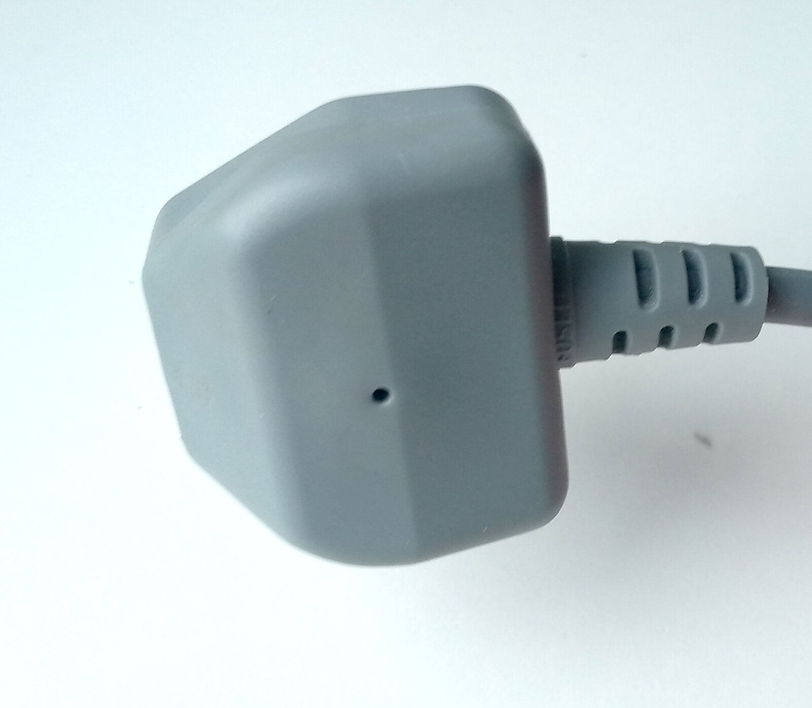

Look how nice this looks, smooth moulded lines - all the ratings and writing on the inside. Loverly.
There has to be a
View attachment 324944View attachment 324945View attachment 324946View attachment 324947
Why cant someone come up with a nice moulded plug with push connectors or something. Like how these work https://www.quickwire.co.uk/product/quickwire-switch-load-junction-box/
I suppose someone will eventually use wago types connectors inside a plug

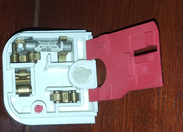

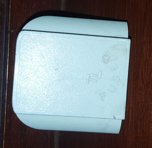

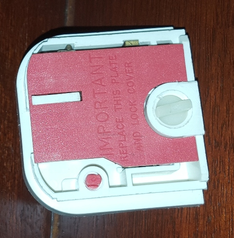

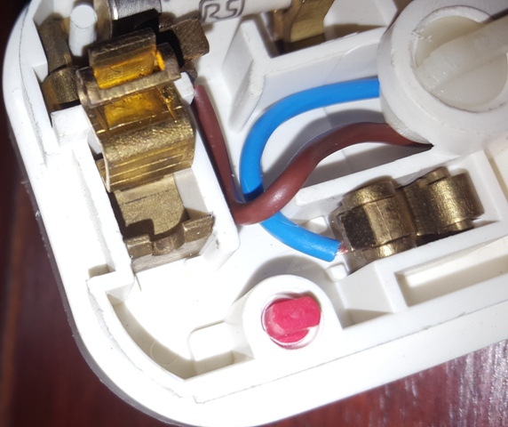

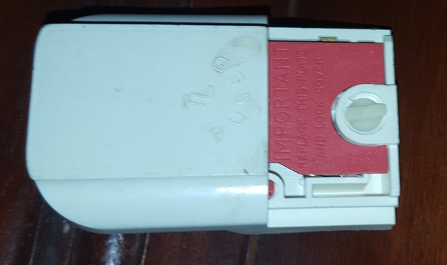

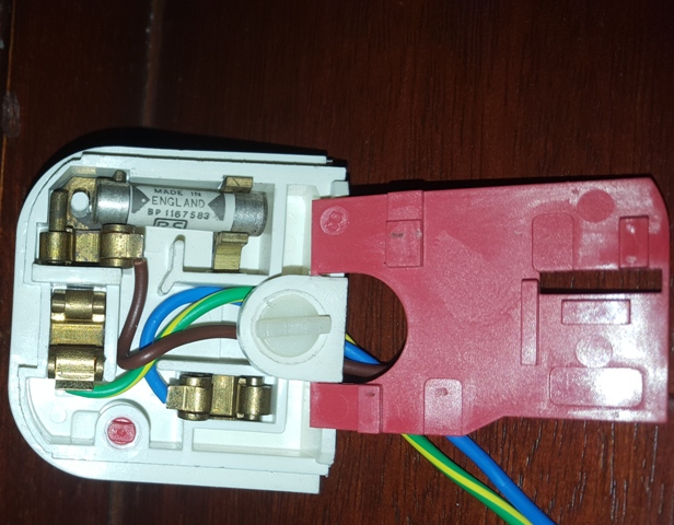

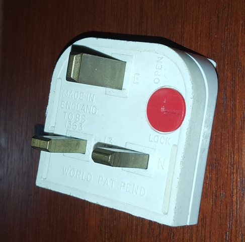

AFAIK there used to be a plug with tab style connectors for the cables. I might even have one somewhere. I must go and have a look!
Found it
20231212_173215.jpg20231212_173227.jpg20231212_173252.jpg20231212_173303.jpg20231212_173310.jpg20231212_173559.jpg20231212_173624.jpg
the red circle on the bottom is the cover lock, the cover slides up and off, but you can turn it with your finger! and the cables aclamped by the u shaped holders as seen in the last pic. havent got a clue when I got this or where it came from

Well, it's certainly 'different' ;)

If you must have holes in the work top, then why not buy the moulded plug with flex, put flex through the work top then join to the appliance flex (chop off plug) with either inline connector, or some kind of plug/socket (thinking kettle lead/lawn mower connector - earthed).

OMFG I'd completely forgotten about those pieces of p155 poor unreliable and non compliant objet de parc
I don't need to buy the flex as the dishwasher and washing machine already have a nice looking moulded plug on flex.
I do not have room in where they are to fit a fused spur (I know) and a socket under the worktop nor do I have room to fit the same in a nextdoor cabinet.
So would I be allowed to do that then electrical wise. Cut the appliance flex at a point that reaches under the worktop keeping the nice plug and then reconnect the two ends with a 3 pin connector like this
