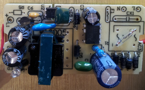

It looks like a simple device with few components. I have tested all the diodes to confirm they are OK. The fuse is fine. While it worked, the LED light came on as soon as I plugged it into AC. Now, it doesn't come on, and there is no DC output. Although the LED will still come on if there is power coming from the DC side. I can turn it on with my multimeter's power while testing the diode beside it. The LED is at bottom left of the first image.

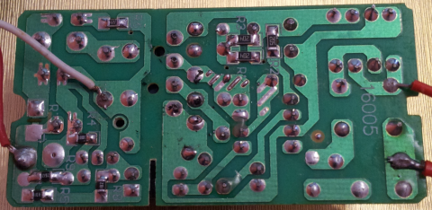

The adaptor failed after an almost inaudible pop. I can see no burn marks anywhere, and none of the capacitors looks exploded. The following images show DC output on left and AC input on right.

Theres nothing obvious on the back of the PCB, that I can see.
...but I'm definitely not an expert! :)

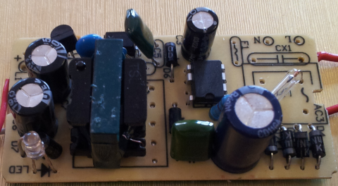

Don't worry, I'll take info from anyone. But, it doesn't mean I will use the info. Here's the front, LED and DC on left:
My first thought is the IC has blown. Any lumps, spots on the upper face of the IC?
There is a lot of noise inhibiting company missing.
The big IC is 8115E 2131. The top surface is totally flat. From a certain angle, there is very very faint water/burnt mark. This might not be anything. From certain other angles, the model engraving/marking is perfectly clear and the stain is not visible in that angle.
The small IC is PS 817C 2N26. No noticeable stain on that.

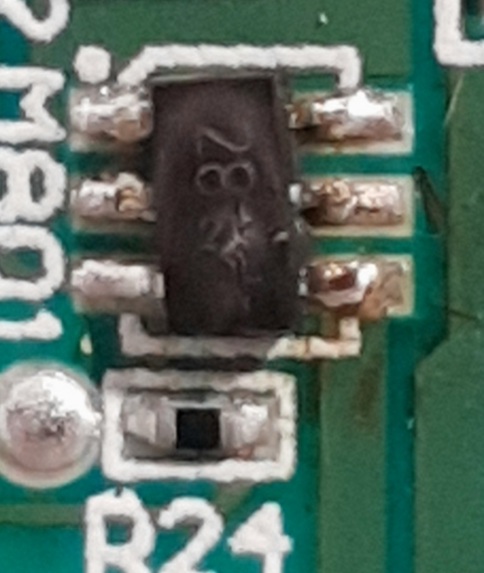

...it's not possible to tell from the pictures, but are there any marks on the transistor (in my experience they can pop from the flat face)?

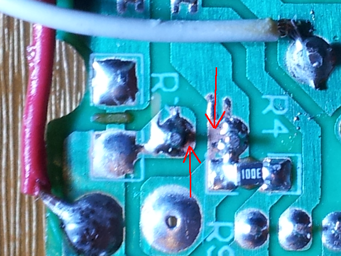

On the DC side, under one of the two capacitors, fresh bare copper of the PCB pads are showing where solder should be. I am guessing the solder was blown "CLEAN OFF", eastwood style by the exploding capacitor as the battery resisted high voltage charging. The arrows indicate the bald spots around the capacitor legs. Initially, I assumed that was caused by poor factory assembly.
I wonder if there was a 'surface mount device' solders between the 2 flagged solder pass that has blown off.
WeI wonder if there was a 'surface mount device' solders between the 2 flagged solder pass that has blown off.
It doesn't mean there wasn't a component there, but there isn't a silkscreen for one.
The connection is from 0V to +V on the output, so if a component was missing there, it would be of little consequence anyway - the failure of the PSU would still be elsewhere.
