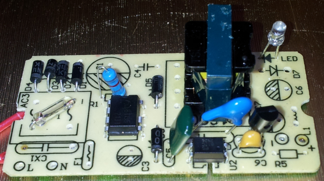

...it's not possible to tell from the pictures, but are there any marks on the transistor (in my experience they can pop from the flat face)?
Unless the IC failed internally, there's nothing on the outside that would lead me to believe it's blown. The surface is totally flat from my feel with the finger.

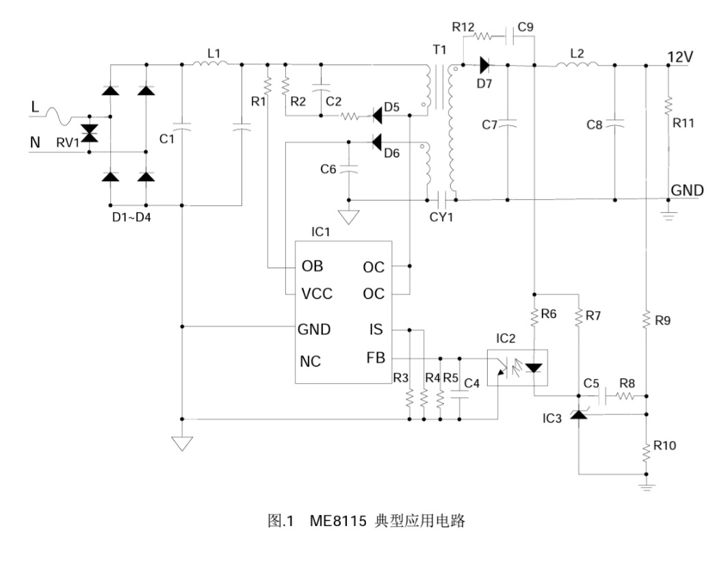

Try instead an ME8115, and the schematic might look a little like:
Datasheet attached.
How do I check the transformer?
As per the schematic, check the resistances between these connections:
...and it would be interesting to know what load you were attempting to put through this little device!
Its maximum power output is 18W, and that's if the other components are suitably rated.

The transformer resistances are:
orange 0.2 ohms
purple 2 ohms
green 0.2 ohms
orange 0.2 ohms
purple 2 ohms
green 0.2 ohms
We can't really do a proper measurement of the impedance of the transformer, without some AC - but this at least shows the windings aren't open circuit.

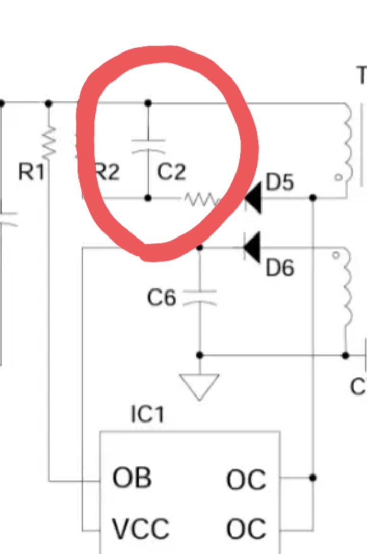

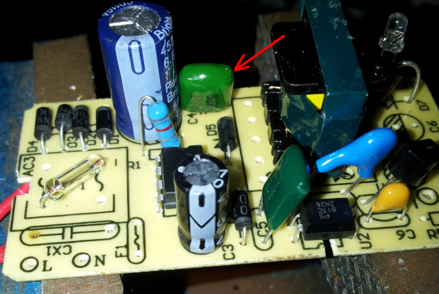

Found it. What is that thing and how do I test to confirm? What would cause it to blow?
It's a film capacitor. Maybe faulty manufacture, rather than any external cause of it's failure. You can confirm it with a capacitance meter, or an ASR meter..
False alarm. The apparent crack in the polyester capacitor is only visible under camera flash conditions. It's normal packaging sealed under plastic. The capacitor is marked [logo] 272 1200V. It's most likely 272J 1200V, the spec of which is 0.0027µF. I took it off and measured 2.77nF.
The fault may well turn out to be the main IC or the transformer because the remaining 5 large components on the board look unburnt and undamaged. I have to confirm they are really OK.

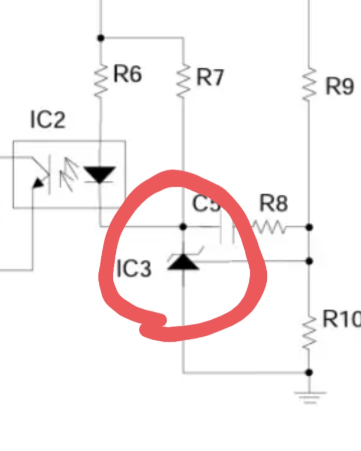

In the above photo, what are the markings on that black plastic cased item, which looks like a 3-pin transistor package - adjacent to C6?
I'm thinking, it may be a triac, and has failed..
The marking on the black 3-legged thing is: H431 BA [logo]
