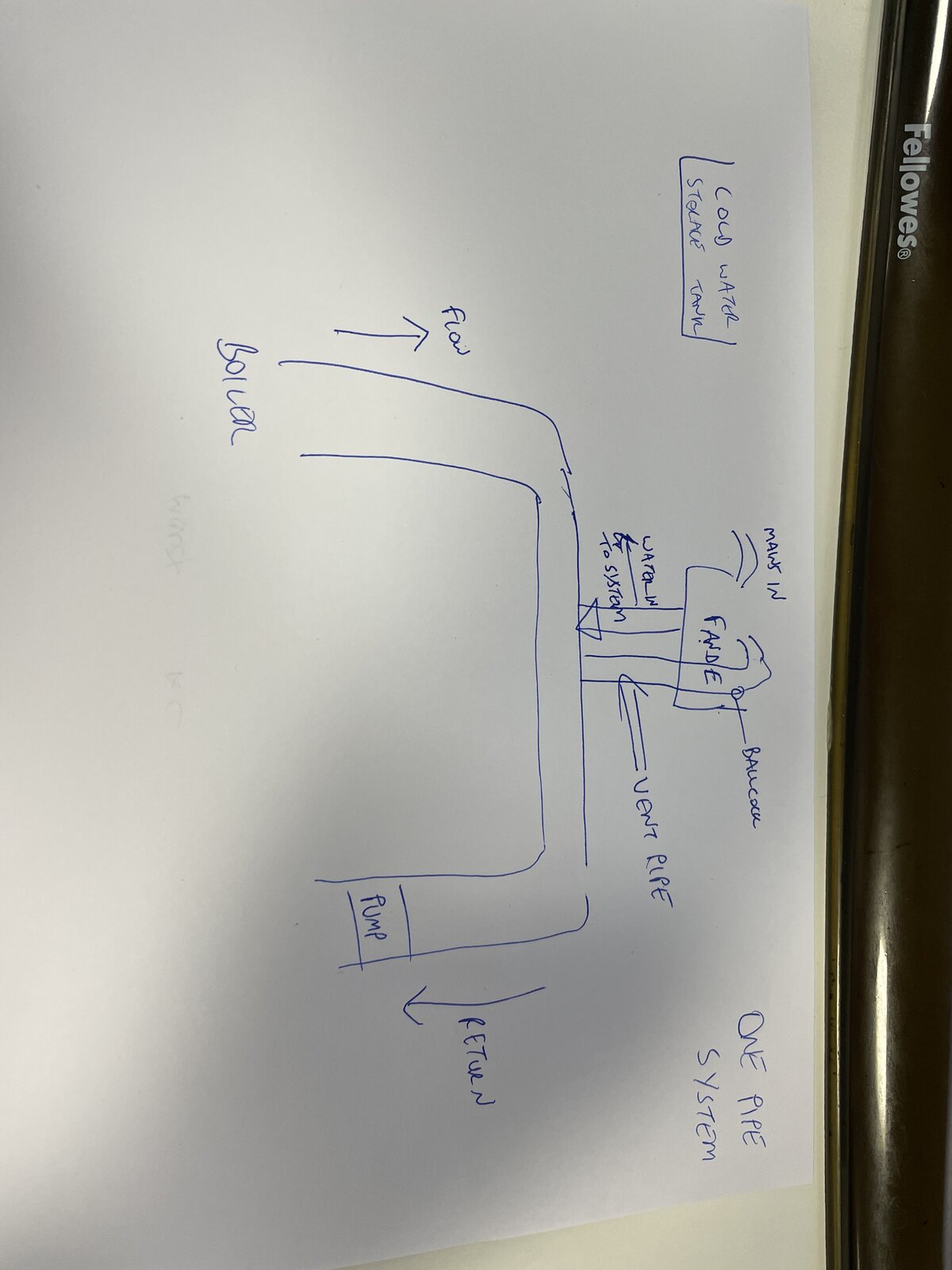

Adding MagnaClean To Flow - Two Pipes On Return
My FandE tank and vent is in the middle of a system - I would think most homes have this setup - My pump is on the return at the moment

Here is a diagram of the current boiler layout
THe F&E tank cold water in is via a ballcock, is this what you mean?.

Just to be clear I have a seperate Cold water storage tank - The fande is for heating system only - It has a ballcock
The location of the fande in the diagram is for both mains water coming into the fande tank as well as how the system is filled - The system is filled at the highest ppoint in the loft from the FandE

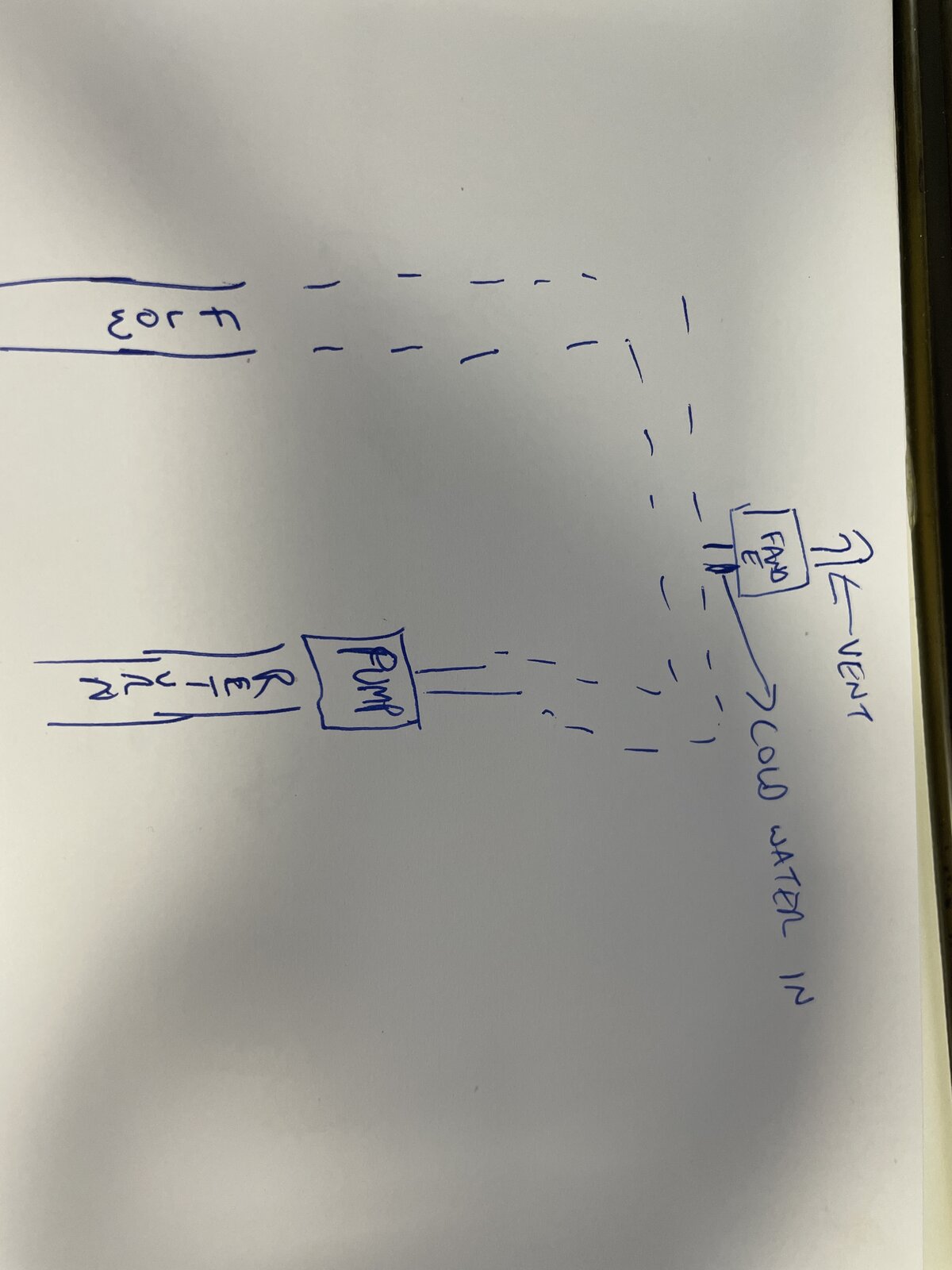

Any advice on pump position given the layout of cold water coming into the system
Sorry Jack, but I'm still confused.

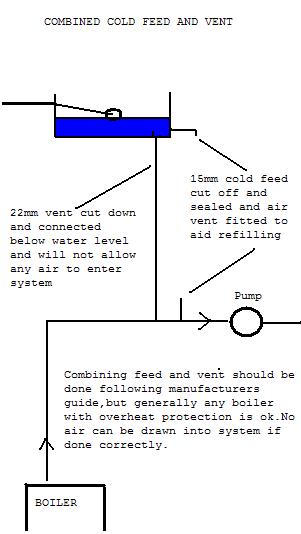

Normally, one has, as you say, a CWST and F&E tank but both have their own filling ballcocks fed from the mains.
I have seen open vented systems where there is no vent from the system, with the cold water outlet to the system which is also the expansion pipe, there is also a overflow which is installed high up on the side of the tank. If yours is like this then it should, IMO work very similar to my combined cold feed and vent.
Don't look at the drawing in relation to the flow and return, rather in relation to where the feed and vent (F&V)from the F&E cistern is located. That's why there isn't a boiler in the drawing. That's also why the pump can be anywhere on the system as long as the design principles are applied.
The pump location in relation to the F&V is to avoid the pump either pumping over through the vent or the air being drawn in through the vent, both increase system corrosion significantly.
It was always easiest to locate the pump in the airing cupboard below where the F&E cistern was usually located, that way the 'H' section ( the area that @DP mentions that tends to block up due to crud being caught) where the feed and vent join the system could be placed in the same space in the correct orientation and distance to/from the pump.

If you only have one feed and no larger vent rising up and over the F&E cistern then it must be a combined F&V.
If the pump is on the system after the F&V on the return, then the system will be mostly under positive pressure > Fig3. The closer the pump gets to the F&V on the flow side of the pump, then more of the system gets into negative pressure as more of the positive pressure will find the path of least resistance which is usually back up the F&V, which isn't ideal, of course height/distance is very relative too
If the pump will only be moving forward by a small amount, in relation to the size/length of the system then the impact of that change should be minimal but without being onsite and actually seeing everything, it's never easy to be sure.
Also when changing certain system layouts, it can also be trial and error unless you can see everything or you installed it all, but it is much easier for a pro to correct any issues that may be introduced, as it's usually easier to alter.
Here is a clearer diagram
Any advice appreciated on pump position
The vent should be before the cold water feed and the pump should be, IMO, be mounted close by. If the cold water feed is I think 22mm or greater then you can just blank off the vent but would need a air vent or two to help when filling the system.
