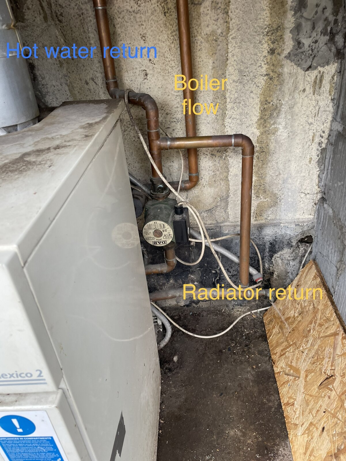

Looked at the picture OP posted. Strongly suspect not a one pipe installation.

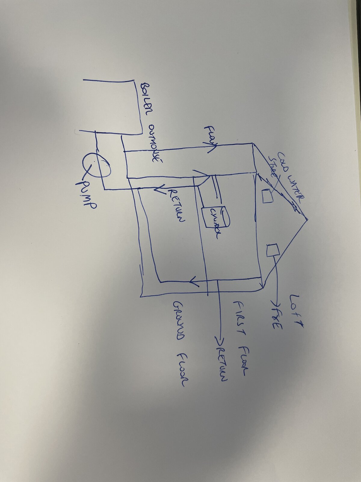

Latest drawing posted also not making sense

You will find you have two pipes running round your house, one is flow and other return, not a single pipe that each radiator sits on ( would be normal to have inlet at high tapping and return water at low point. Both radiator connections to single pipe for one pipe system.

I definitely have a one pipe system - I am sure of this and confirmed by many engineers - It is 2 inch steel pipework..
Heating engineers have advised replace all with new pipework.
I have one flor from boiler which then tees off for hot water at airing cupboard and continues up into the loft

I think, as suggested, if DIY'ing you want to leave things the way they are. My advice would be the mag filter goes on the return from the rads (if that other return is the primary) and then add a cleaner, empty and flush your whole system a few times and then inhibit it correctly. Alternatively, re-pipe that section so there is enough pipe on the return at the boiler to fit the filter. Or, again as suggested, get a good CH engineer in to survey and sort out your system.
Here is picture again. I am sorry for confusion
100% one pipe system.
Lets go back to basics and the first pic ..... there are 2 returns, one running along the bottom with the drain on it, that then runs up and onto the same return pipe coming down into the pump. Is one of the primary return (from the HW cylinder) and is the other from the rads?

Which on is which? If the lower one is the primary return which I am guessing it may be as it's the last return on the pipe then OK, so to solve your original problem ......
As was suggested at the start, take that lower return and tee it into the vertical return pipe higher up, then re-pipe down to the pump location to give you enough pipe to cut in the filter & then fit the new pump below it and then hook back into the boiler return pipe.

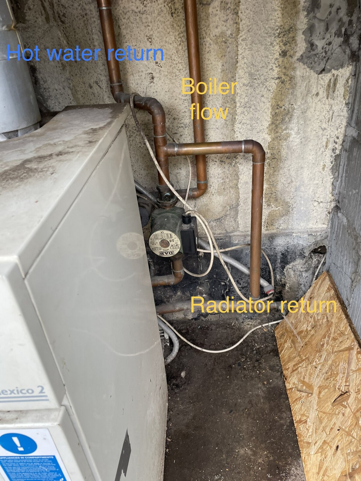

Here is an annotated picture of the boiler. It’s a simple heat only boiler
Where should the magnavlean go

Read what Rab wrote and others too. I suggested return from the radiators.
