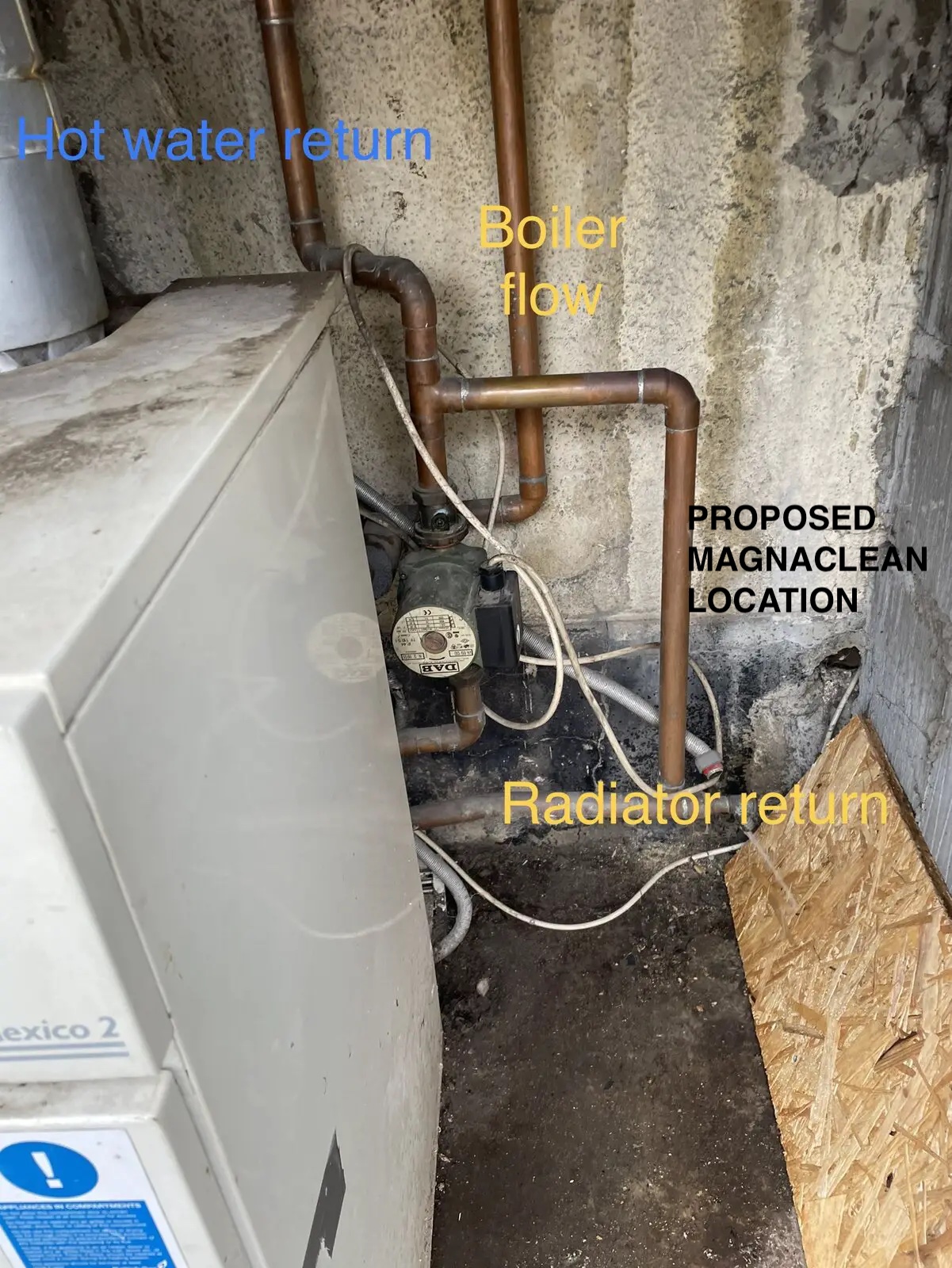

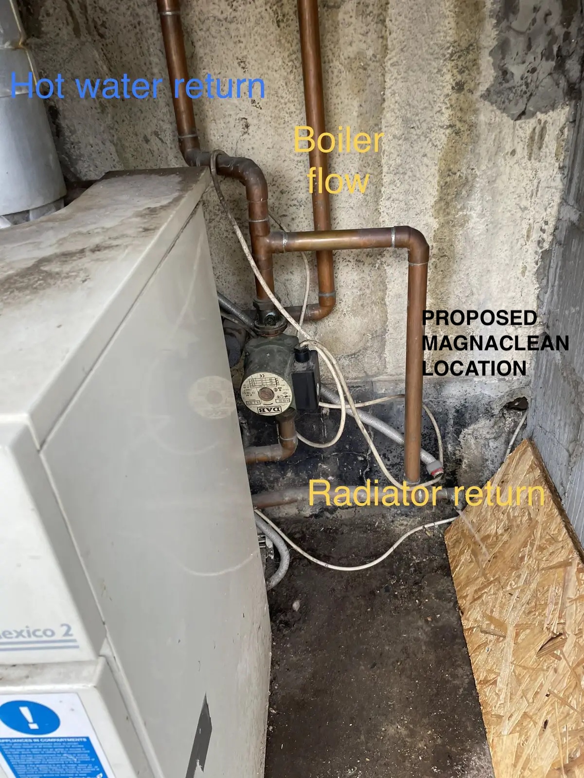

I think I understand the feedback - Attached is the final layout of where the magnaclean will be fitted - It will only catch the radiator return which I suppose is better then nothing - I stopped thinking to put it on flow based on your feedback

Hi again - Before I add the filter I just wanted to see if anyone could comment on whether the location of the filter i have identified is correct?
As was suggested .... Majority of any corrosion will be from the radiator circuit, so without actually changing the pipework to bring the rad return in higher up from the pump and then allow the vertical return before the pump to be extended to fit the filter, then your location should be fine
Also ... put cleaner in, run for a week or 2, drain/flush/drain/flush till it runs clear then fill & inhibitor then warm/circulate the CH system once a day ... check and clear mag filter after a week, keep doing that until it stops catching any major amounts of crap.
If you can’t change the pipes around then yes. But you can also add another filter onto the boiler return as a third option.
