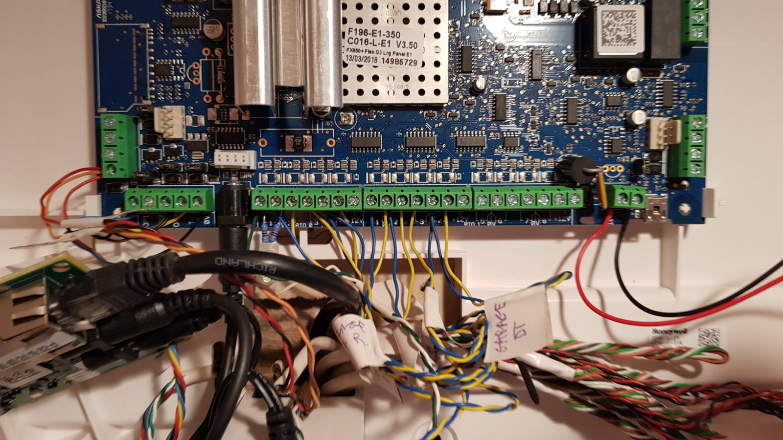

1st Snag... The new unit has 2 sets of zone connectors it appears labelled ROI OO (4 Zones) and ROI 01 (8 Zones)… I've started wiring the zones as they were on the old unit from left to right which has meant I have zones 5-8 now spare on the ROI 01...
Is that right? Do I simply need to put resistors across these or should I have started at Z1 on ROI 01 bank of connectors?
Pic...
It doesn't matter. All zones are fully programmable. It's best practice to place a 1k resistor across any unused zones. Although they get programmed as 'spare', adding the resistor makes the engineering exit sequence faster when it checks for tampers.
