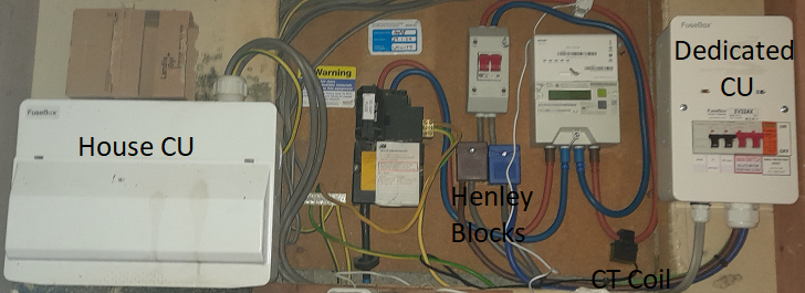

Hi
I have a 32a supply in the kitchen for cooker and looking to use that for 7kw EV charger, as I can swap to a gas cooker instead of the electric. The cable from the consumer unit is 6mm and 7m distance. The charger will add another 4m to that cable run. Any advice will be appreciated.
The supply is coming from this fuse

The likely best option will be for the Electrician to install a brand new final circuit for the EVSE rather than trying to butcher something else. Surely you need power for the ignition anyway for the hob so might as well leave that as is. The EVSE cannot be on a shared circuit.
not looking to share but remove the Electric as we plan to revert to gas cooker
Even though its not actually over 32A, I would be unhappy with having an connected to a standard / non-uprated way in a wylex standard board (as it appears OP has) because an EVSE will be pulling on the limit for that way and pulling it for hours at a time. Plus the majority of these boards had 60A main switches.
Its either a fuseboard upgrade required (which you do need anyway) or a separate 1way unit for the EVSE adding. Converting a reduydant electric cooker supply with an RCD in an enclosure stuck on the kitchen wall is not the way to to it, especially as you'll likely need a pair of cores back to the mains for the CT on the incomming supply anyway.

It will depend on the EV charge point used, what is inside the charge point varies, what I would expect to see is at the origin of your supply, a CT coil around the in coming supply to monitor the total power used in the house, this is connected in some way to the EV charge point, which in turn relays the information to the car so it can adjust the power being taken to ensure you don't exceed the total supplied to the premises.
The method often used is a special cable from the supply point to the EV charge point which includes a data cable. The EV charge point may use a wireless data link, but we are looking at all the other protection also required, like loss of PEN detection, and DC current detection, and the RCD, the installer will select a unit that suits your situation, where I would the supply to the EV charge point is dedicated to that job, so an easy install, but in the main one has to split the supply, the use of henley blocks seems to be favourite, I would expect some thing like this.
This is actually for solar panels, but likely you will end up with some thing similar. There are actually two CT coils, the top one just above the meter works my immersion heater, so it only runs when there is excess solar, there needs to be a gap between the two coils, they can and did interfere with each other.
