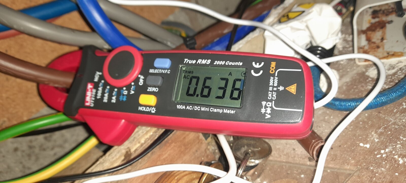

I don't know if you have tried to measure DC on an AC supply, I have with this CU use 8 Feb 24.jpg clamp on, which I will admit is cheap, the requirement to zero, every time the meter orientation is changed makes it hard to use, may be more expensive meters are better? I can measure 6 mA DC but would not want to rely on it being under 6 mA with a hand held meter.
Now the AC scale is another story, again 1 mA increments, but far more steady, so testing to see a circuit is under 9 mA (30% of RCD rating) that is easy enough. However 543.7.1.1 tells use 3.5 mA so clearly we need a meter which can measure that low, for equipment using a plug and socket and not being to BS EN 60309-2 not sure if the plug and sockets used with EV's are to that standard?
