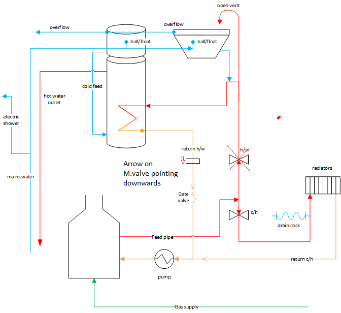

Airlock in HW Cylinder Gravity Fed Open Vented HW/CH system

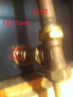

I don't think that you have an air lock. From your diagram to me it looks like the system is lacking in
"Circulating Head".
You could try turning the speed on the pump up, however, I don't like that combined cold feed and expansion idea in connection with this.
You could also gain a bit of CH by levelling out that primary flow by taking out that drop in the flow pipework.
The modern solution would be to convert to a pressurised system by removing the expansion tank and fitting an expansion vessel in its place.

Re position it as shown.
Shut off mains water yes, drain F&E tank only, shut the gate valve, open compression nut above the gate and drain down the remaining few litres, re tighten compression nut, open gate valve fully, latch open both zone valves, then just (barely) crack open the mains, this will/should allow the air to vent and the water to flow downwards in the same pipe(s), has worked very well for me, only real difference is that my combined vent and cold feed are right up at the tank but should still work OK in your system.

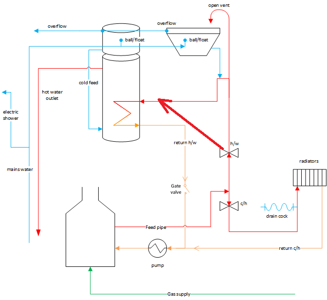

Understood about the zone valve for h/w although the horizontal leg in real life this is only about 10cm long. The diagram placement of items made it difficult to represent that properly.

I should explain that the pipe work for the h/w is short in distance as everything is located in the airing cupboard. The height from the floor to the cylinder connections is about 1-1.5m. The c/h works fine and the overall distance of all the radiators is much longer. The pump is set to speed 3 which is the highest.
The only air vent is the overhanging vent above the f&e tank pointing downwards. Other than that there is no other air vents I can find. The gate valve is open as you turn it anti-clockwise. It also stops and doesn’t continue turning.
I'm surprised the coil is airlocked, positioned as it is very close to the flow&return piping, are you absolutely sure that the gate valve is open, if it is, then you should get ~ 3 to 4 full turns clockwise before its fully closed and visa versa to reopen.
The M.valve can be re positioned on the vertical return leg (again, ensure it already isn't), just ensure the arrow on the valve body is pointing downwards in the direction of flow.

I missed this one.
Johntheo5 is spot on!
If that diagram is correct, and that HW MV ever shuts off the whole system then becomes a bomb.
#1 Priority ASAP to move it.
Surely no one fully qualified in plumbing will have done this.
The circulating head is measured from the base of the heating expansion tank to the centre of the heat exchanger in the cylinder which must be very low with everything in the airing cupboard and that high loop in the flow reducing the head even lower.
Check that air is not being pulled in from that expansion pipe with the pump on 3 it will be far easier for the pump to favour this over circulating the water in those primaries.
Conversion to a pressurised system looks to be the only cure for me. However, you must get that motorised valve positioned changed before you do anything else.

Apart from any safety implications not life or death just now as the expansion is open to atmosphere as long as the gate valve is tie wrapped fully open, but only as a temporary measure, you will never get rid of the air except that the HW zone valve is re positioned as suggested as the vent is just that and must always be open to atmosphere.
You might also install a air vent (either auto or preferably, for me, a manual type), you may be able to T it in on that short 10cm leg into the cylinder coil.
Also suggest running that 5M pump on speed 2, can't find any pump curves, I am running a 12 rad system for 50 years at a equivalent 3.5M head which your pump should deliver at the above speed.
Get someone to watch the vent for a spurt of water when the boiler starts and also when it stops, also hold a "glass" of water with the vent immersed in it and see if the level changes with CH only, HW only & CH+HW on.
