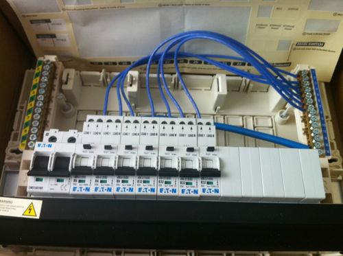

As an update, I'm going to go with the Memshield EAD11R, with the Memshield 3 compact RCBOs. It's not particularly well publicised in the MEM catalogue, and it's hard to find many references or pictures of it online. The best pictures I can find of it are actually from an eBay auction:
The Memshield 3 Compact RCBOs are pretty small and the layout (neutrals and earths at the sides) will be very convenient for me, with all my incoming cables entering from the top of the box. Seems perfect!
http://www.ebay.co.uk/itm/EATON-MEM...UK_BOI_CircuitBreakers_RL&hash=item485386d859
Been quoted about £25 per RCBO and about £45 for the consumer unit itself from a local supplier. That sounds OK, as I'm doing this for fun rather than profit. Tempted by the eBay auction, but a bit worried about eBaying something like this. Besides they've already stuck the labels on. :)
