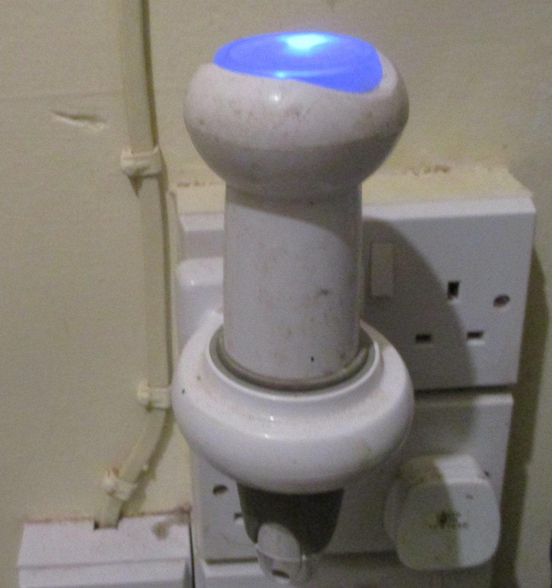

But now we're talking about it, I'm thinking that an emergency light where each of our smoke detectors is (and maybe powered from the alarm circuit) wouldn't go amiss. Then it's whether to make them standalone or use maintained fittings and replace the ceiling rose with them.
Providing enough emergency lighting to avoid any dangers resulting from 'being plunged into total darkness' need not cost much. I have a few things like the one in the photo below dotted around my house in strategic places. They probably don't cost much more than a tenner apiece these days (and have no installation costs) and mine (which have replaceable rechargeable batteries) have been in service for years. In the event of lost power, they come on at full brilliance and can, of course, be lifted out and used as a torch, and they glow dimly when there is power, to reassure that they are 'working' - also flash if the battery is dying.
