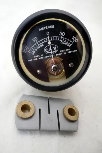

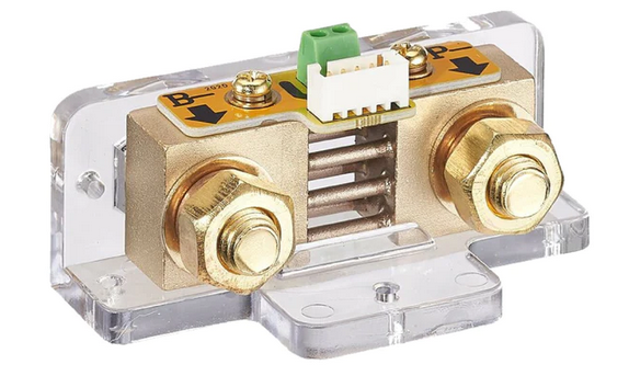

The shunt is fitted close the battery and the voltage created by the current flowing through the shunt is taken to a voltmeter on the dashboard by a pair of small wires. Although measuring volts the meter is calibrated in Amps.
In the main the ammeter is a volt meter measuring the volts across a shunt, in the old days the CAV 208 alternator had a shunt between the alternator and battery to control the alternator output with the 440 regulator between M1 and M2 terminals, these were one of very few alternators to have current control. Normally only found on buses and coaches, designed to keep the lights powered while engine ticking over.

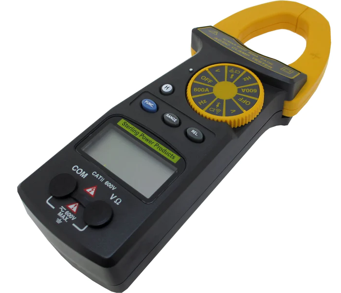

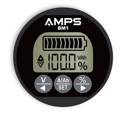

I think Durite still make an ammeter but CAV and Lucas were part of British Leyland so when they went so did the major British auto electric manufacturers. Ring and Durite are still going and Stirling is big on the canal boat scene. So this 1688711579422.png1688711705701.png is the type of thing we see today, cost over £100 made by Sterling Power and likely can be found in boat chandlers designed for the likes of narrow boats.

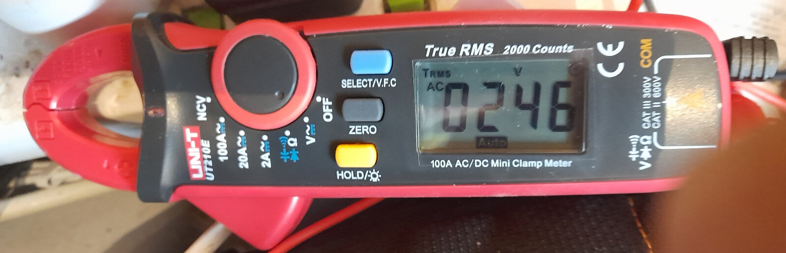

Today I use my clamp on when required, the cheapest clamp on to measure DC is around £35 from internet, but more like £100 from an electrical whole sale output, as in the main electricians need them calibrated, and cheaper models you can't get calibrated.

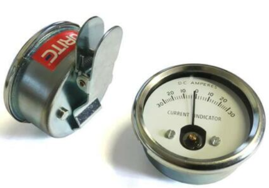

These 1688712377144.pngcame in 30 and 60 amp versions, the square version seems to have gone, the standard automotive test set
is still made by Durite, sure you could order one from any auto electrical outlet, the modern one 1688712873752.pngis rather expensive, and as an auto electrician one needs both amps and volts at the same time, so the old one was better, but I now use
And sorry unlikely to find one except on the internet, at £35 so much cheaper that screwfix price £96 for cheapest DC ammeter.

So tell me; how dose it messuring volts dose it calibrate at amps?
If you run current thru a resistance/impedence (albiet a very small one) then if you measure the voltage across that resistance/impedance you can manually or automatically calculate the current.
Example, if you run the current thru a resistance/impedance of 0.1 ohms you can measure the voltage and therefore calculate the current and the 0.1 ohms when compared to other resistances in the circuit wiring will not really much affect the readings in many circuits.

the current goes through the large terminals and at the top the small plug has the very small voltage that goes to the meter, the old CAV used the same shunt to work ammeter and alternator control 1688809160222.png The metal lump shown below turned current into voltage, it could be trimmed with a hack saw.

Those Lucas style ammeters were invariably moving-iron rather than moving-coil types and had only one or two turns of heavy copper driving a magnetic pointer. As such the full measured current has to flow through the meter. So not really practical for the modern vehicles need. Apart from that £80, for a recon unit takes the biscuit.
In fact the 'shunt', need only be the resistance of the existing cabling.
