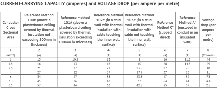

I would say no, unless the fuse/MCB/RCBO had been modified, however if we look at the chart, ref 100 which is normal, 27 amp is the rating, so only ref C would allow the use of a 32 amp MCB.
This paper talks about the problems with extra insulation. and I can see how even 6 mm² is really too small. Yes, I know one would need to take a very long shower for there to be a problem, but all it takes is a phone call, for a shower to be left on.
I can see both sides for code C1 and code C2, personally I would code it as code C2, as any codes C1 need addressing immediately, which gives just one option, disconnect it. Code C2 gives 28 days to correct it. So 8 kW = 35 amp, so in the main a 32 amp MCB will hold for long enough to have a shower, but the next size down is 25 amps, or 5.7 kW, and it is unlikely even a 7.5 kW shower (32 amp) will hold long enough to complete one's shower.

You've moved the goalpost slightly, by now talking about 10.5 kw Showers and 4mm² cable "protected by B32s or 30/35A fuses", but, even in that situation, I personally still cannot see how it could possibly qualify as C1, and might well struggle to regard it as C2 - as you say, C3 might be appropriate.
"10.5 kW" showers are invariably 10.5 kW at 240 V, which equates to about 41.9 A at 230V
Method C 4mm² T+E has a CCC of 37A. It would be deemed to be 'safe' if it were protected by a hypothetical 37A MCB, and by virtue of the spec of such devices, that means that the cable would be deemed to be 'safe' (come to no harm) with a continuous current 'for ever' of about 41.8 A, and 'safe'with a current of about 53,6 A flowing for an hour.
The situation you describe would, strictly speaking, be non-compliant with BS7671 on at least two counts (ib>In and In>Iz), which might well be considered to justify a C3 - but, in view of what I've written in the previous paragraph, I would not personally regard the situation you describe as even 'potentially dangerous' - so not even a C2, let alone C1
I can see both sides for code C1 and code C2, personally I would code it as code C2, as any codes C1 need addressing immediately.... . So 8 kW = 35 amp, so in the main a 32 amp MCB will hold for long enough to have a shower, but the next size down is 25 amps, or 5.7 kW, and it is unlikely even a 7.5 kW shower (32 amp) will hold long enough to complete one's shower.cable 'at any danger' - since, as I recently wrote, it is deemed to be able to carry about 41.
Per what I've just written to Sunray, do you really believe that any of the scenarios being discussed constitute a "potential danger", hence deserving even a C2 (let alone a C1 !).
What do you thing is "put at danger"?? A 10.5 kW shower draws about 41.9 A at 230V and that current is certainly not going to put 4mm² cable 'in any danger' - as I've recently written, such cable (Method C) is deemed to come to no harm with about 41.8 A flowing indefinitely, and about 53.6 A for an hour. What 'danger' did you have in mind?
