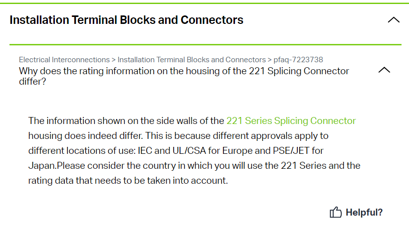

Are these connectors man enough
It's in their linked knowledgebase/FAQ
The approval criteria are different.
I think that the PSE/Jet certification of 300V 20A is only applicable to Japan
If using UK electricity I believe that the 450V 32A certification applies :rolleyes:

Where did you see that? It shows 20A @ 300V.
It comes from the spec in the Wago document ti which was linked to -it's the difference between "IEC/EN ratings" (at 450V) and "UL ratings" (at 600V).
However, I suspect that the difference between the two in current ratings is not entirely (or necessarily at all) related to the voltage - since I can't really see why 'voltage' has go it anything to do with a connector's ability to carry current. All a connector knows about voltage is the very tiny pd across it - and it doesn't know whether the circuit in question involves voltages of 1V, 50V, 500V or 50,000V (all 'relative to something'!).

It'll be "permitted temperature rise" or somesuch which may even be measured over different time periods.

Another factor I suspect will be relevant is that American standards bodies will presumably want to test with american wires, and perhaps will not want to load those wires any higher than would conventionally be allowed by American electrical codes.
The largest american size supported by the Wago 221-4 is 12 AWG which is about 3.3 mm². Americans normally rate such wire at 20 amps*, so rating the connector the same seems pretty natural.
