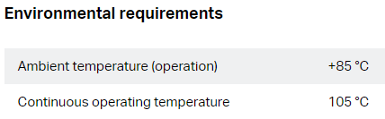

However, what do people think about this bit from the spec of the Wagoi connector we have been looking at ...
... does that really mean that, if the connector's rated current is being carried continuously, the temperature of the connector might riuse by up to 20 °C? If so, would that not be a indication that the impedance of the connection might be worryingly high? Admittedly, 105 °C would not be high enough to 'start a fire', but it still would not sound very satisfactory (at least, to me).

You really are worrying too much and, in any event, the spec seems to be saying that, as far as UK/EU are concerned, the connectors are rated at 32A.
