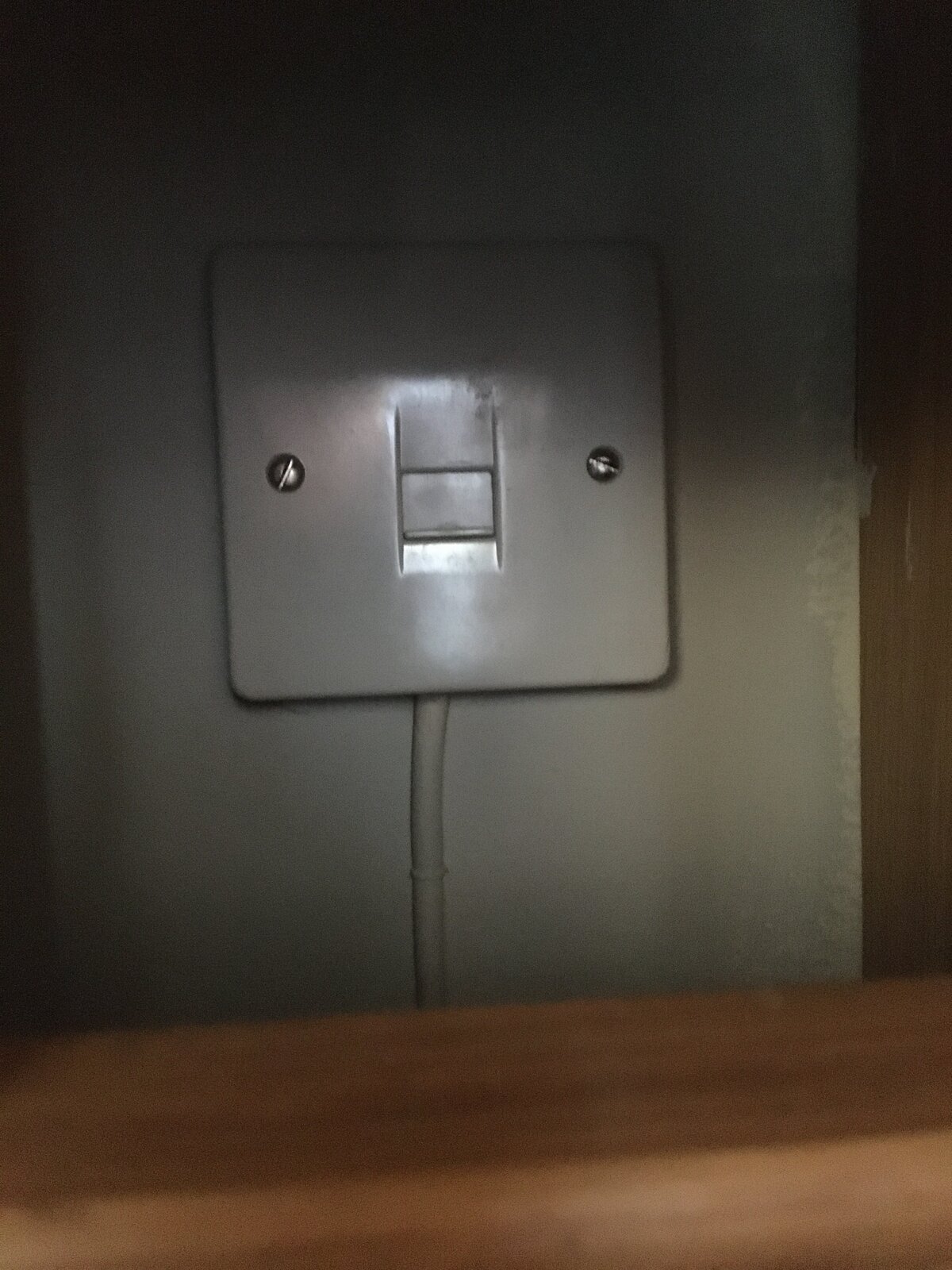

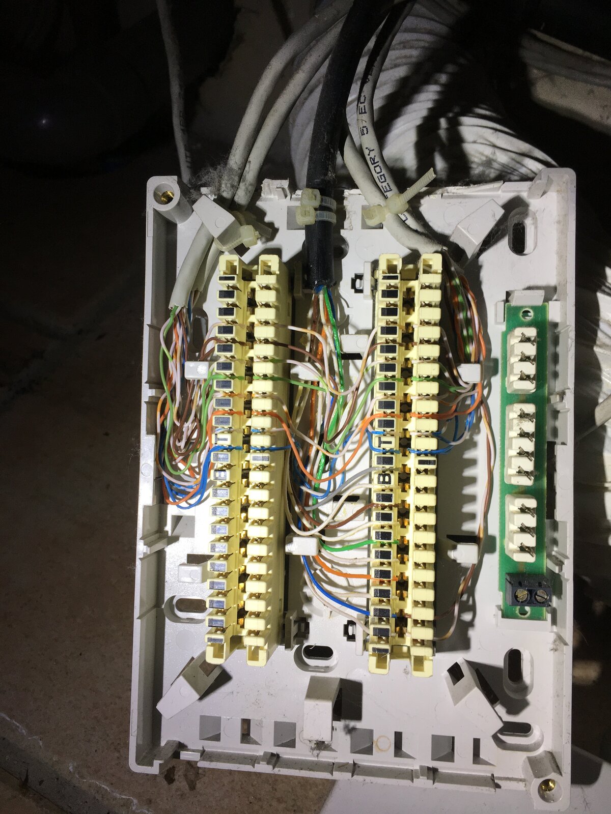

Im looking to get off Virgin onto Fibre (Fibre to Cabinet) but before I do I need to figure out some internal socket stuff. I have only used Virgin for phone and BB since we moved in 5 years ago so I have no idea on the state of the BT line. It comes into the house (10 core cable) into the big distribution box shown and 4 Cat 5 UTP cables run off it to what I assume are phone sockets around the house.. I only found two 'normal BT' sockets in the house...
1) Will the new installation for phone /broadband use one the existing BT sockets (pictured) or will the engineer as I suspect come and have to do some install work on the cable running into the existing distribution box and install some new outlet panels?
2)The current BT sockets and the distribution box are in now terrible positions as they have been boxed in by the previous owners fitted units. I have no idea if the engineer will have any obligation to run cabling to suitable locations.. I guess not as it would be a ball-ache job.
2) I guess that If I plug a phone into the one of the existing BT sockets I will get no tone? Just thought Id try and test as much as I can before getting an engineer in.
Thanks for any help.
Scott.
