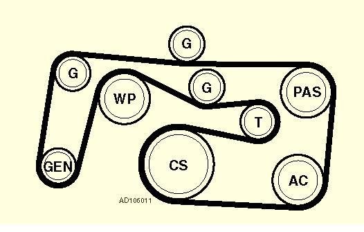

Thought it was worth a shot in here .
My car shed a pulley on the engine the other day and I am about to put a new one on .
The poly v belt came off at the same time ,losing ,power steering ,alternator charge ,ABC function etc .
I am not sure how the belt went round the pulleys as it was off when I opened the bonnet .
Does anyone have a pic of the belt in situ so I can copy the right way to refit it .
Many Thanks if you can help.
