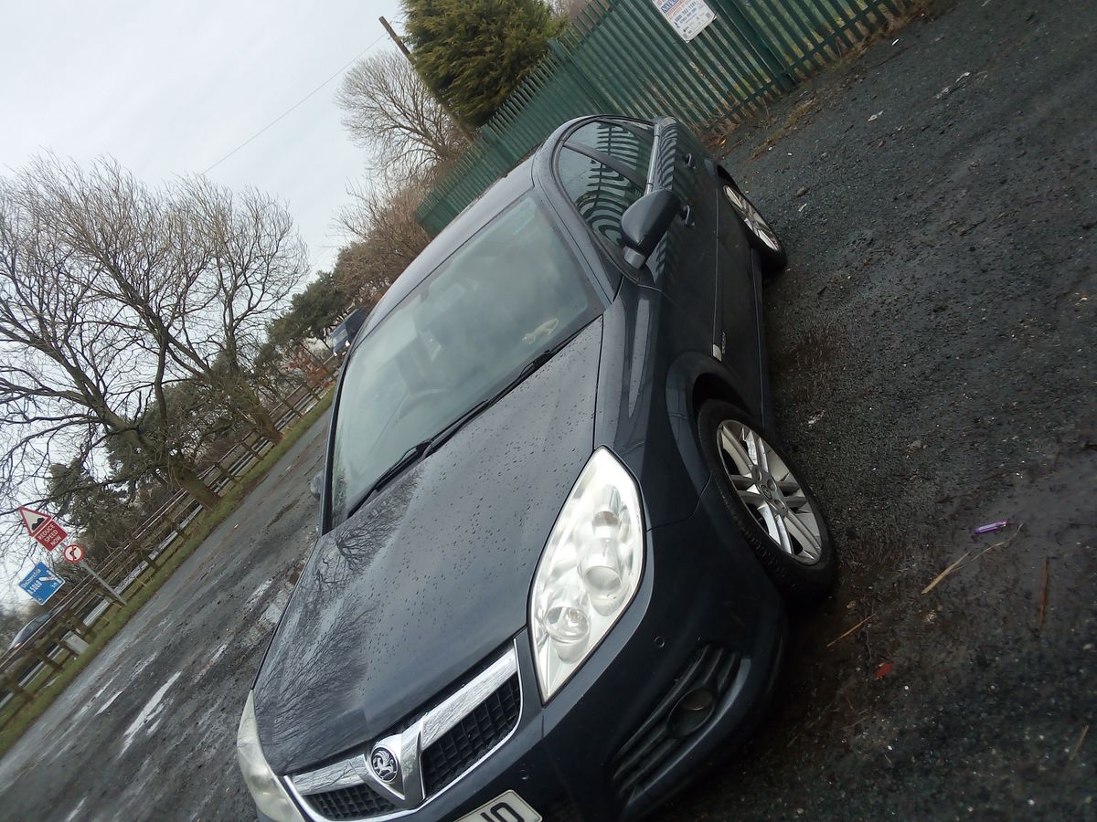

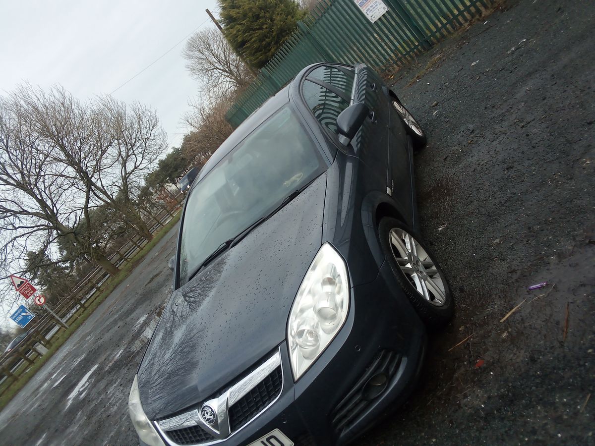

I like my vectra, it has parking sensors front and rear from standard I believe and they are very good at accuracy. I have had it 3 years and it's had a few jobs the biggest being the Dual mass flywheel and clutch but that is a consumable anyway as on most cars and baiscally notihng else major has been done, I got the cambelt and water pump replaced about 46,000 miles ago and will be getting them replaced again in about another 10,000 miles.It is a large practical and economical car for it's age, I'd say it acgieves about 40 - 45 mpg around town and 60 + mpg on long motorway journeys and combined around 50 mpg
