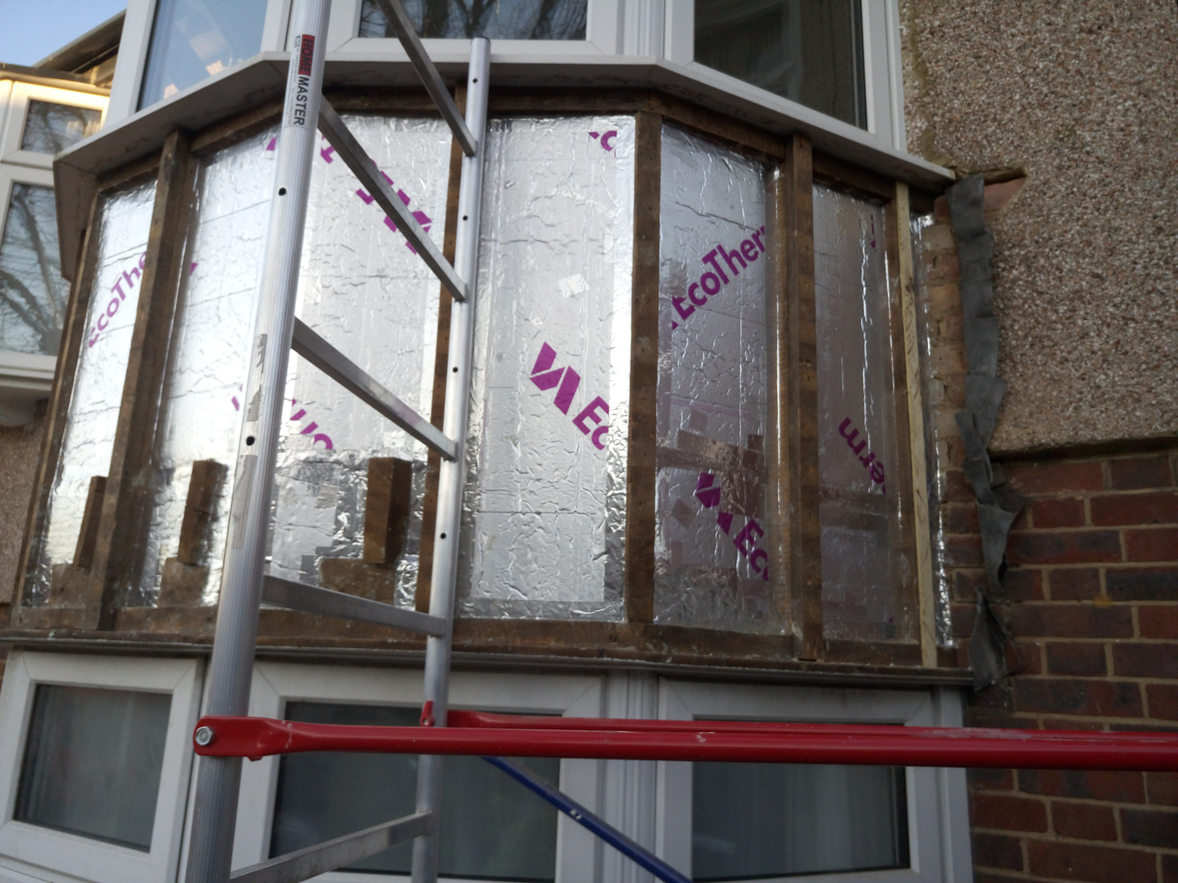

I would batten that with 25 x 50 and nail the tiles back, cut the battens and you still get three batten fixings.

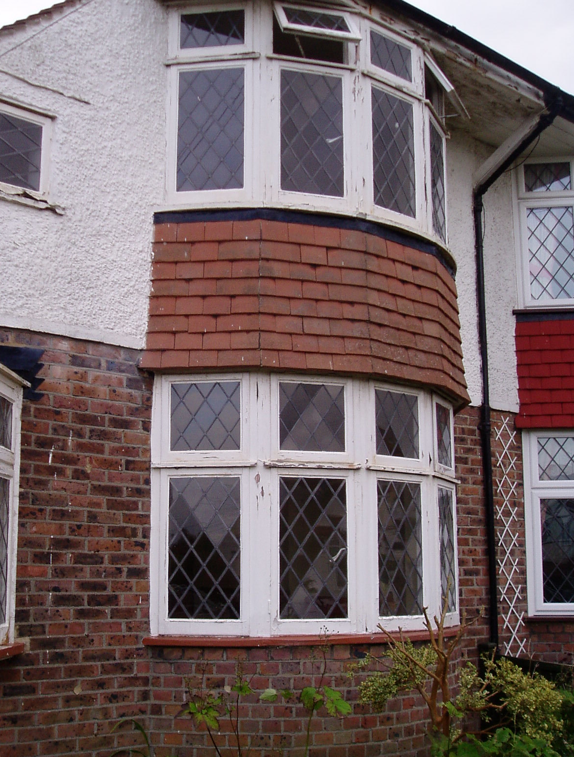

I'll definitely consider that, the photo was from the right-hand side, so only three sections of a five section bay are showing.
The bay was previously tiled to a curve, as are all the bays on my street, I imagine that straight batten sections will mean that the bay would no longer be tiled on a curve but more in straight sections!?
I would have expected 1 1/2 x 3/4 .. but 2 x 1 (25 x 50 ) will work and stronger there is no need to bend anything on that bay, I had expected an eyebrow or a proper curve
The battens I took off were single length and curved all the way around, I've seen some identical bays that have been retiled nearby, and the finish is not as good as the original, specifically, tiles jutting out at angles, presumably where straight sections of batten meet. Even though the bay appears as straight-line sections, the result has to be like a circle segment

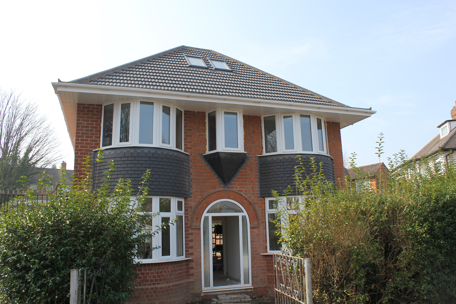

The first picture below being a more sectional bay, the second being truly curved
The pictures are what you have and what you would like. the curved is constructed to achieve that.
ply would be the easiest method, but tiling prowess will govern the finish.
The first picture is just one I pulled from the internet, the second picture more accurately represents what the bay was like, but with ninety-year-old tiles before I tore them down to insulate and retile.
First picture is the same construction as yours. The second with the Marley Concrete plain tiles on is built differently and is wider .
