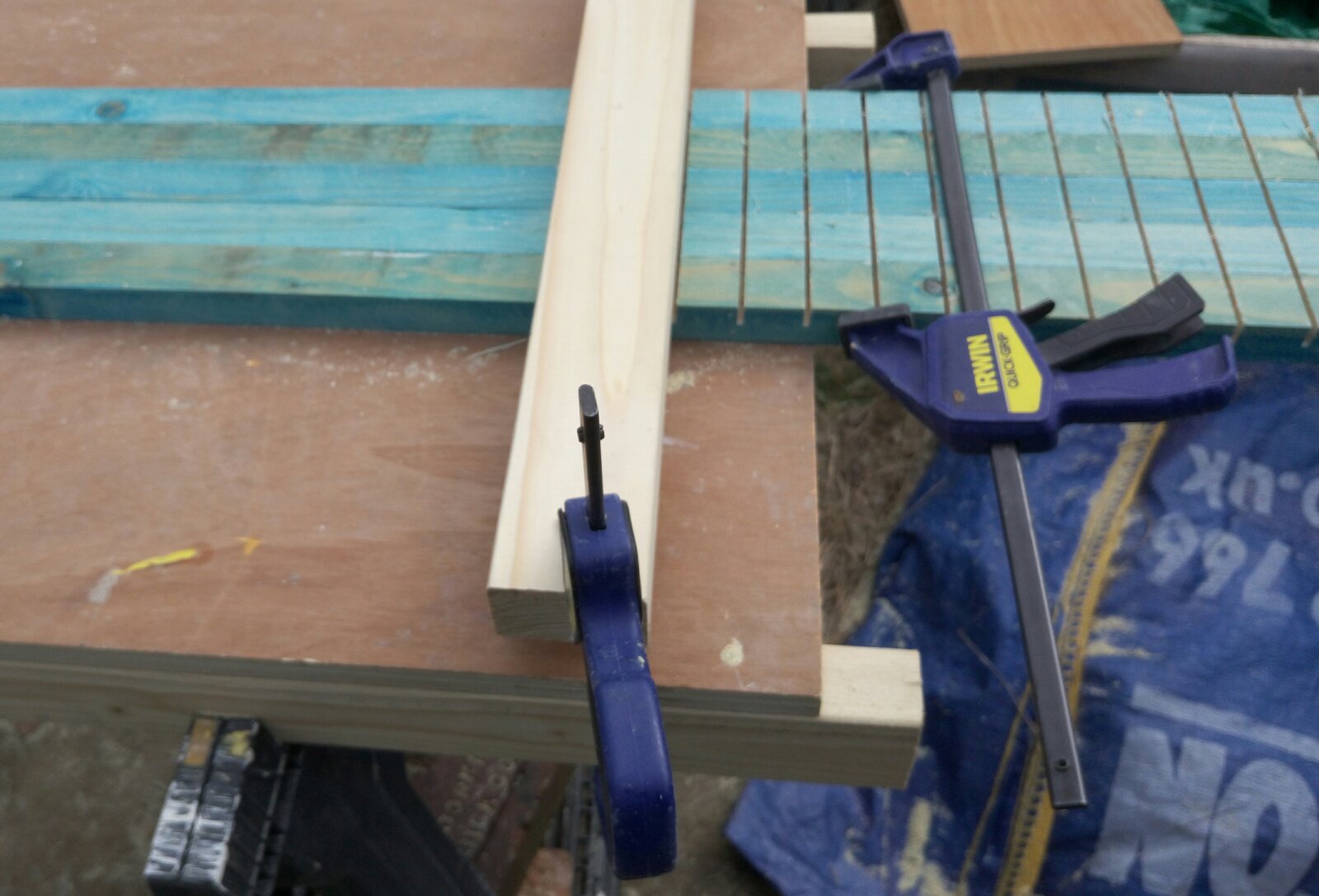

I used 25mm battens, better to buy fully graded, a bit more expensive though. I kerfed the battens at 35mm, at 12mm depth.
I then poured boiling water on them, which helped a little bit, then I bent them around the brick part of my bay window at ground level, holding them in place with concrete blocks.
Still, the bending part needs patience, go slowly. as soon as you hear the slightest crack, find out where it's failing. At that point, for the weak points, I used a curved template with G clamps, and glued a thin strip of wood support on the back of the batten, and clamped in the curved position.
I had also stripped the plasterboard on the inside of the bay, and if I'd thought a bit harder, I would have bent the battens in-situ and clamped to the uprights, as both sides of the uprights were open.
I also started pilot drilling the nail holes because I found that the kerfed wood would split out at the back when nailed.
I used Lumberjack polyurethane wood glue.
Even with all of that, I found that only half of the battens would bend without breaking somewhere.
you might try 13mm kerfs, and not sure if it's a good idea, but once curved you might glue thin strips into the kerfs to strengthen the wood. I'd be interested in other people's opinions on that in particular.

I initially tried with 25 X 38mm graded battens and kerfed the back to about 14mm depth. Left these to soak for a week in a bit of a jig and then tried to get them in position. Wasn't having any of it so then got some 18mm slate battens but not graded. I've tried soaking these for a week but they're exactly the same as when they were dry and just splinter upon the slightest tension.
I then had the idea to steam them but all I ended up with was a floppy bit of 68mm downpipe that I've since made into a snake for the kids!
Sounds like you kerfed the front facing part of the battens, when I tried that with mine they just snapped straight away. Unless I'm not understanding the glueing strips bit that you mentioned.
I've found that any slight imperfections in the batten cause a massive weak spot if they're bear the middle of the bend and also to cut the kerfs on the side of the battens where the saw marks are visible as this seems to be the propagation point of the splits when they happen.

Where a batten had an obvious weak point, I kerfed it, then clamped on the weak point and glued a supporting strip of wood on the back (kerfed side), and curved to a plywood template I made
So the kerfed side is on the inside of the bend, the inner face.
Not sure at all, but soaking the wood that long might weaken it, anyone else know about this? I think the heat is effective, the boiling water seemed to help for me. A few rounds of that.
I didn't try ply wood, and I probably wouldn't, if I had to do a similar job again
I used stainless steel screws in a few tiles, I think they are recommended for pressure treated wood, not sure though. I just couldn't hammer the nails in on a few centre points between uprights, the battens bounced too much in places, must be a trick to that, but I couldn't figure it out.
The blue battens were from Wickes, and the others from my local roofing company. If you look at the third batten from the top, on the left of the image, you can see what I meant about reinforcing the wood on the kerfed side, at a weak point, time will tell if it's robust enough to last as long as the old tiles and battens I tore down (85 years).
I cut the kerfs with a circular saw.

See what you mean now about the reinforcing strips. Can't see it being a problem as that wood glue is very decent stuff. I suppose the battens will ease over time and some of the tension will cease.
After the battens had soaked for a week they were pretty slimy and still not flexible. The closest I got was the kerfed 25 X 38 graded stuff to getting round the profile. I made a bit of a jig out of 4x2 studding to start the kerb but maybe I was missing the boiling water to get them closer.
I did notice that the graded stuff is a lot more resistant to splitting in the smooth cut side rather than the rough side.
