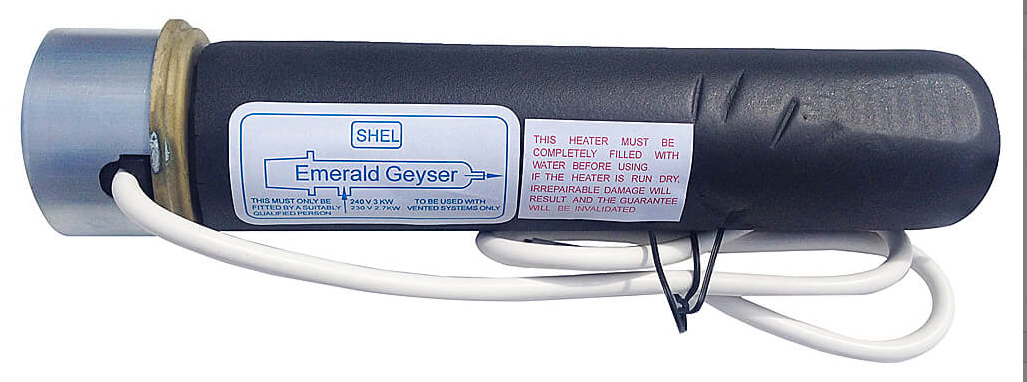

He told us how the electric bill had gone down, likely true as the immersion heater completely removed, and he thought it was working well, until the smart meter was fitted, and then he had no hot water what so ever, at this point I got involved, reason for no hot water was pilot flame had gone out in the boiler, and the solar panel pumps were supplied from a switch marked immersion heater in the kitchen which my father-in-law had switched off, since no immersion heater.
So still did not work after being switched back on, this was summer, so get solar panel expert to re-commission as possible over heated due to pump being switched off, all it would do was take the chill off the water. When he died new owners ripped it all out, it was totally useless.
However the statement for this thread states no town gas supply, but that does not mean can't use LPG gas or oil, but seen no reply as to why LPG or oil not used? Heat pumps are expensive to install, so if only electric can be used, with an immersion heater two methods, direct as with most mainland UK homes, or indirect as with most Ulster homes, the Willis system has some really good reports, by using thermostats on the side of the tank one can select how much hot water is stored, and you can get enough hot water for a washing bowl very fast, but also heat enough for a bath by leaving the immersion on longer, as it heats from the top down, not bottom up like most mainland systems.
However the problem is finding a plumber who knows what he is doing, these Willis-immersion.jpgneed plumbing correctly, and without getting an Irish plumber don't know how you would get it plumbed up?
Well, it became thus through its treatment while in service..
It was to my mind a poor installation, at least the isolator switch should have been changed to say nothing, but clearly marked immersion heater it was asking to be switched off in error.
If it could be damaged by switching off, should be warning on it, there was not.
But in rear terms it was a big con.
