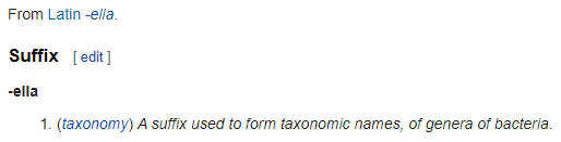

Whenever I read a thread about Legionella this image pops into my mind
Cinder-ella was called that because she worked among the cinders.
She had a sister who worked in a pie shop.
