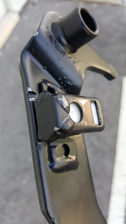

Indeed, you are correct KingboyD
I've looked at some pedals on ebay and the box sections that the white clip goes into does indeed have a plate for the clip to push against.
That's been the problem and can now be permanently rectified - many thanks.
In my defense (rather meekly), it wasn't me who repaired the clutch the first time it went and when I did repair it the 2nd time it went, I'd made the assumption that it was the black clip that retained it when it fell out as I dropped the bulkhead trim cover. It never occurred to me there was a broken off metal plate missing from the pedal.
I must admit though, the black clips I've been fitting have done a sterling job of operating the clutch.
A trip down memory lane with those pics.....
I remember welding the bracket back on (51 plate Golf TDI) but I don't recall taking the pedal off to do it :eek: Must have been double jointed!
John :)
John they are not hard to get off :) welding it in situ must have been tricky!
DIYSpanner - you know what I mean about cable tieing the spring? Cable tie it like they are spring compressor something on a strut, makes this awkward job a lot easier!!
Also make sure you don't forget to remove the spacers from the old pedal!!
New pedal on order at local VW as a I don't have a welder or any metal plate.
Actually wasn't that hard to remove and your point about the spring is noted - many thanks.

Job done!
Awkward as bloody hell to do, but done.
Spoke to the fella on the VW parts counter this morning and he stated the end plate breaking off is a common problem so evidently VW can't be bothered to fix things. The recent issue of them fiddling the emissions I suppose typifies their attitude.
