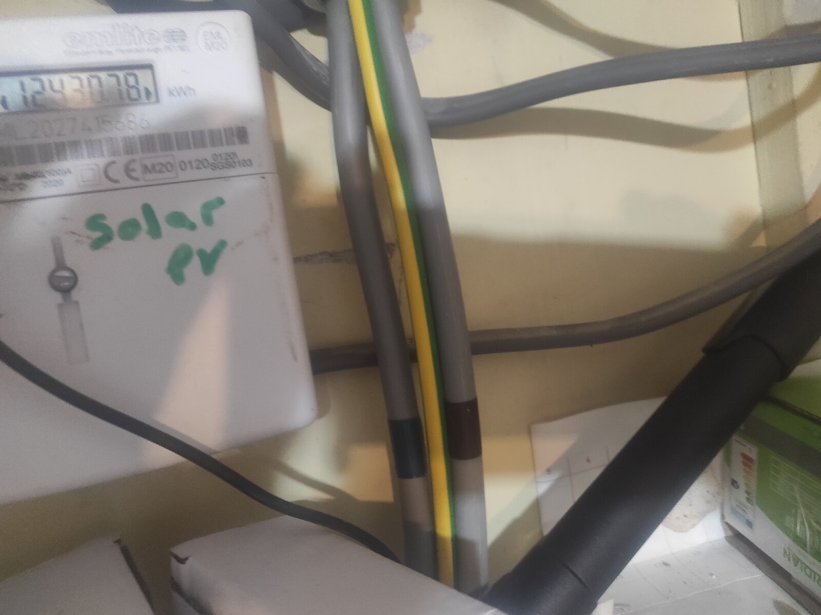

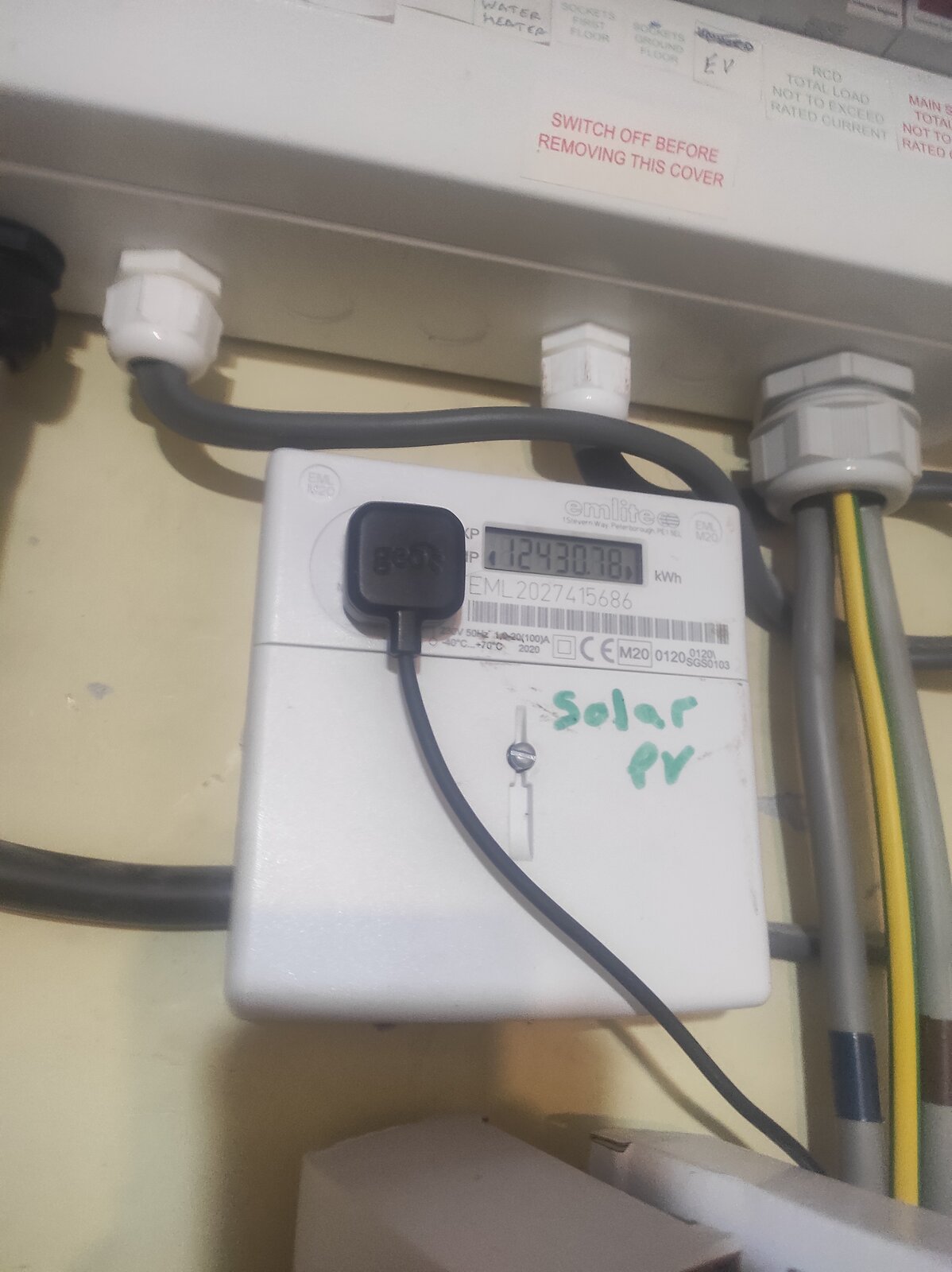

I was looking at the wiring that the solar panel company did and they just have the SWA going directly to an 20amp MCB in the CU. I thought they would also need an isolator switch there because they have about 10 metres of cable but there's nothing

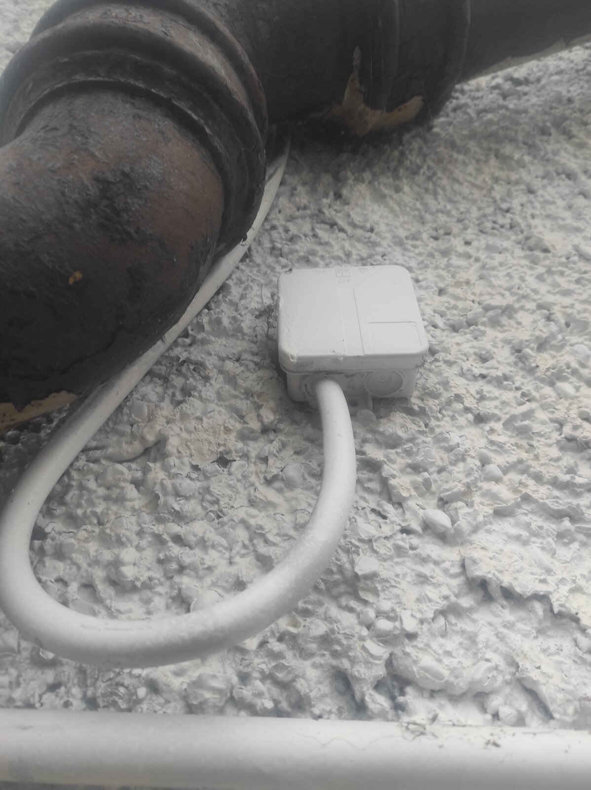

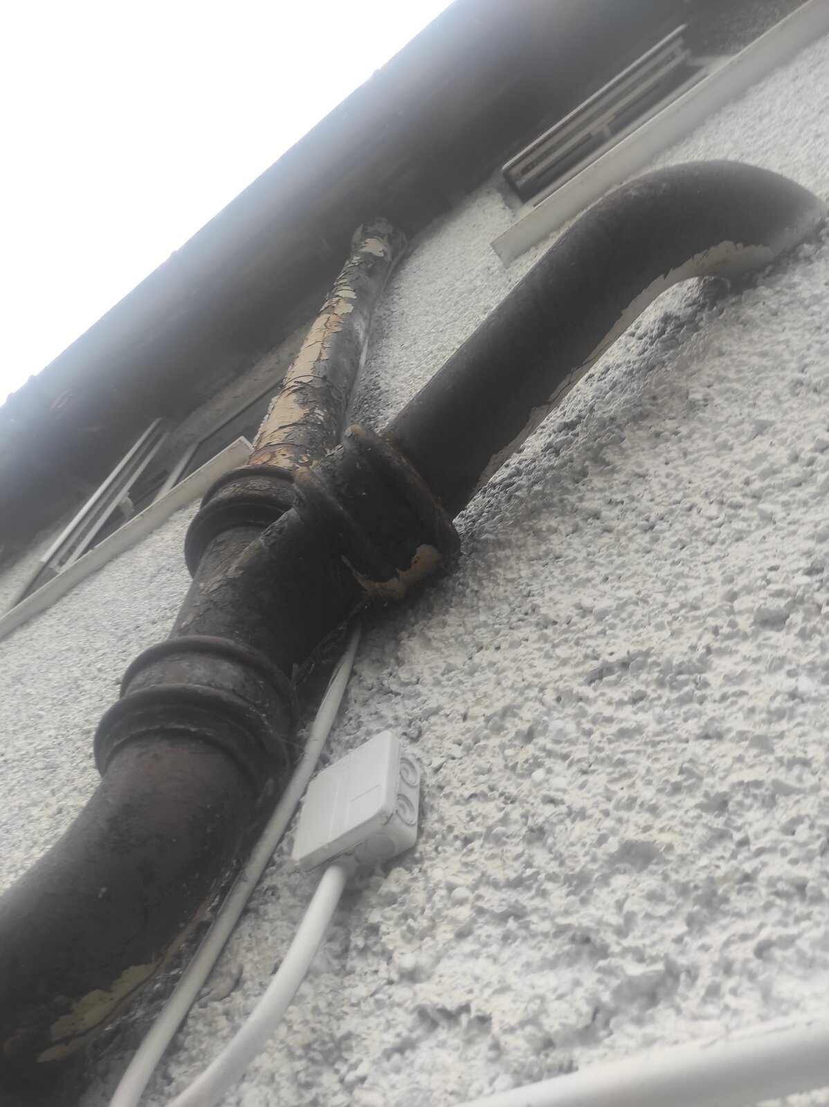

I just had another look at it and I wasn't right on a few of the details. They've got a cable coming down from the inverter in the loft running outside down the drainpipe to an IP67 type junction box. I hadn't looked at it closely before and said it was SWA but it actually looks like it's not armoured but just has similar black insulation. Then 2.5mm t&e cable running from the junction box to the PV generation meter and then a short piece of the same black cable as comes down from the roof going from the generation meter into the CU to a 16amp MCB type B. It's a 3.9KW PV array that generates about 3KW on a sunny day. Shall I get on to the company?
