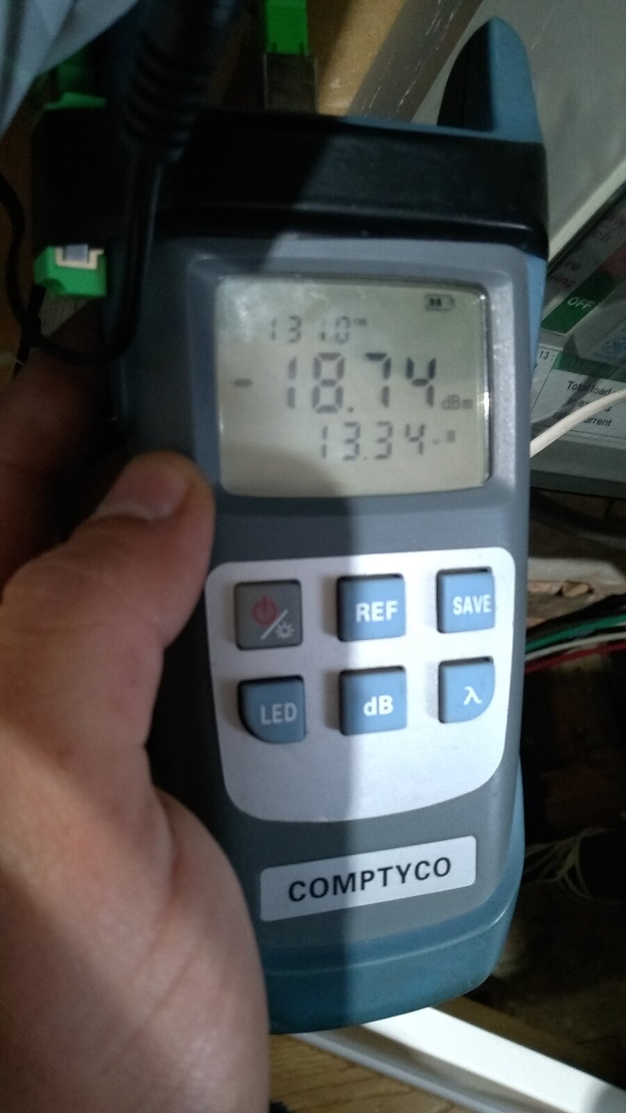

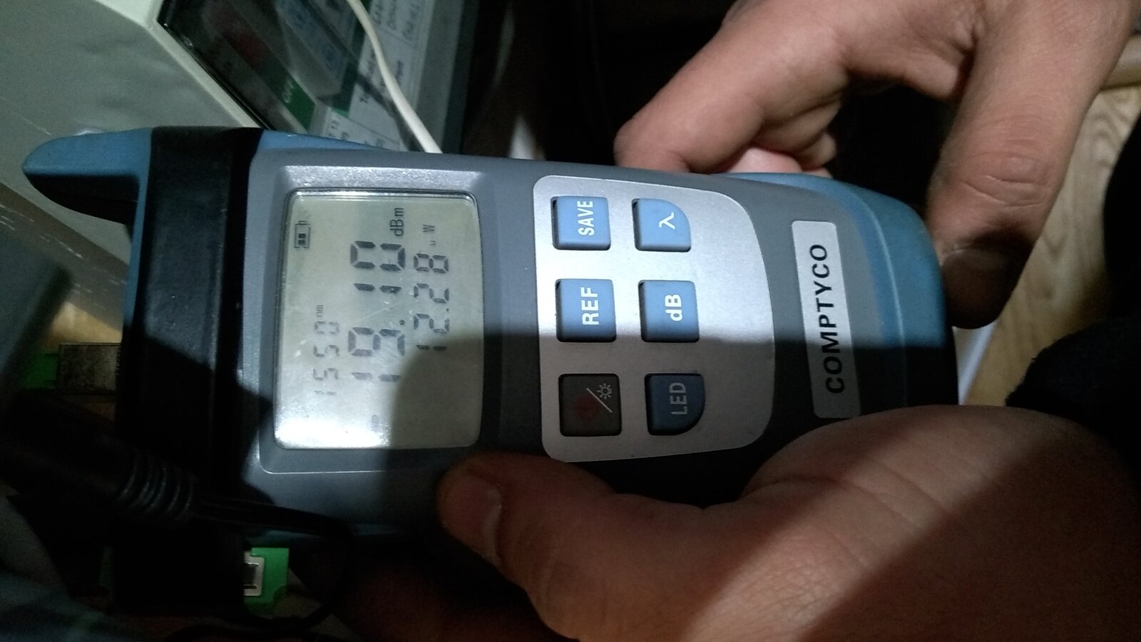

Fortunately tests for DB show no loss -- I toot the liberty of taking a picture of the test results on their tester.

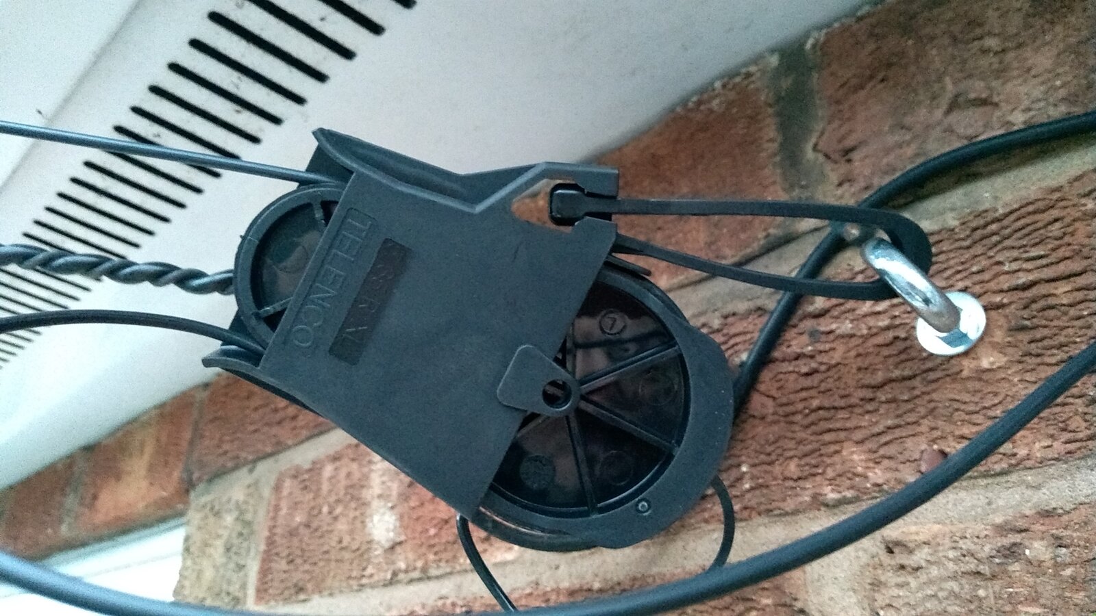

The clothes line contraption, is likely what I have - to be fair, I have not really looked at that part.
I did because I was up there with him - I was on top of my canopy directing the route behind the flashing in a corner :LOL:
Its this, I think its pig ugly. In the picture you are also seeing the old copper twist attachment and cable - the fat one in the picture.
Here is the test result at the ONT I think he sait the DB ? is 20 incoming at the post and this tells them the loss by the time its at the ONT. He does 2 tests. Not sure what the numbers mean - only that he said it was very good no loss or at least well within parameters.
I am thinking I know its the speed of light but the moor spare cable you have coiled up - is not going to be any good for the DB/ signal -- thing is it ?
