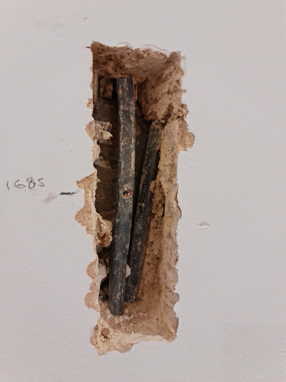

Broken cables in a wall
The above is about 8 inches tall.
On reflection they look like they are 2.5mm T&E. I hadn't noticed that there is a 2 gang socket below it.
The depth of the plaster is 45mm.
The left of the image is dot and dab plasterboard. I suspect that (further) to the right will be dot and dab as well. The customer recalls that the builders forgot to fit a socket and extended the ring via the ceiling (rather than ripping up the floor.
Can you get into the ceiling - floor above?
Perhaps you could alter the circuit and disconnect the damaged cable and making the other cable a spur.
The quickwire looks neat but is only rated at at 24 amps, not sure that is adequate for buried 2.5mm2 T&E.
Be careful which Quickwire connector you use. The info says the Quickwire QSP32 is only 16amp. Definitely not man (should we say person) enough for repairing a ring final.
There is another version, the QSP32-24 which can handle 24amp.
Just got to add - that is a perfect shot right in the middle - what are the chances !!!
Anyway what was the electrician doing drilling a random hole in the middle of nowhere. Also why is he not fixing his mistake.
But is 24 amps adequate for say clipped direct t&e with 27 amp capacity?
The load on one “leg” of a ring final is generally assumed to average 20amp. That’s why I specifically stated it’s ability to do this repair IF it is one “leg” of a ring that has been damaged. We don’t know that is the case.

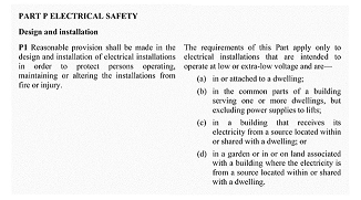

As I understand that it the building regs are rarely if ever prescriptive because a) it would be unpractical and b) someone might be able to demonstrate an alternative way of achieving a desired safety outcome. But if you are prosecuted for breach of health and safety or building regs compliance with the specified regulations will be a full defence. So in effect they are requirements. Or to put it another way you have to show good reason to diverge from them. Fire and rescue simply want to reduce risk of fire or spread of fire. Poor terminations might be the cause of fire but steel casings will surely achieve reduction in spread to allow for safe egress from buildings. Then there’s Grenfell…..
You have changed the subject. The Building Regulations are statutory
All they say about electrics is:
Well, yes, but again, they are statutory; The Wiring Regulations are not.

Its a criminal offence not to comply with the building regs or any requirements under them, that must include Part P and BS7671, simples. The onus is on the sparky to prove how his/her work otherwise complies, it seems to me.
