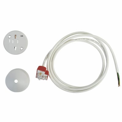

Seen it in white a lot, mainly for single phase and a permanent Live, confusion comes as its not always consistent what is used as permanent live, some use black and some brown.
Hagar tend to use Black as Permanent live in there prewired plugs, and that seems to be the most common way.
Interesting. I have to say that is the opposite of what I would almost certainly do myself - since, in 3-core (single-phase) cables, brown id the ('permanent') L, I would almost certainly stick with that when I used 4-core, using the 'other colour' (black or whatever) as the S/L.

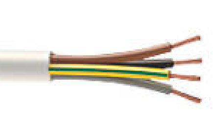

I think all harmonised-colours 4-core flexes I've seen (and used), plus things like SWA, have had brown, black, grey and G/Y cores. My point was that I don't recall ever having seen brown, blue, black and G/Y before - have you?
IIRC grey cores were introduced when the UK moved to harmonised colors for fixed-wiring cables in the early 2000s because the UK objected to having multiple black cores in standard 3-phase cables.

I would quess there use of Brown is because the normal 3 core version, which is mainly designed for connecting normal lights to a single or multi output Klik box, fed from a switched supply as well as a permanent supply (usually via a key switch), uses Brown as what would then be a switched live.
To this day i always open the plug to check as there is no way of knowing for sure, as often the flex is installed by the user rather than buying the preassembled units. we proberly find about 3 lights a year, that go on to emergency when the lights turn off. due to the Brown and Black reversed.
It also seems to be the habit lately of finding Pirs connected using these 4 pin plugs and basically feeding back into the lighting system via the plug. again using the black core.
It dont seem right but i suppose unlike a "Widow maker" the plugs dead as all live pins break simultaneously on removal.
Though when I connect standard Pirs to normal circuits, without these klik plugs, I do what you say and use the Brown as permanent live, though cannot explain why.
Maybe the association of Brown in an appliance flex being Permanent live.

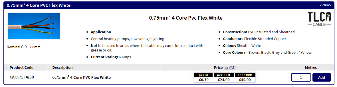

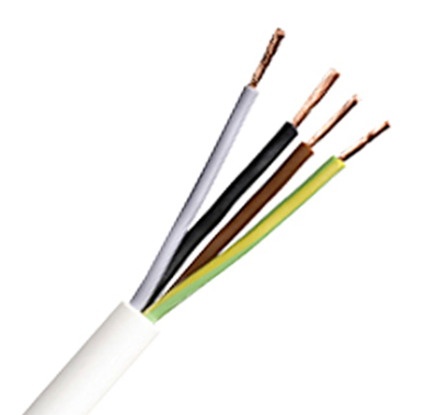

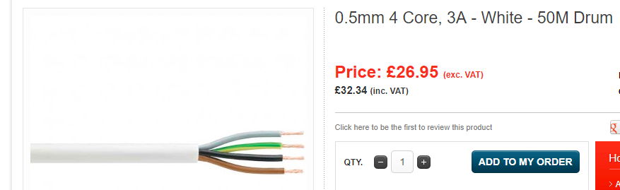

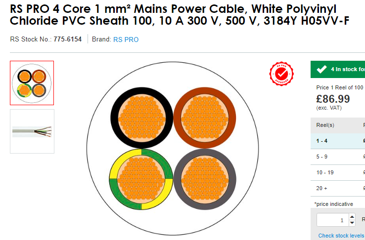

I'm certainly not at all sure about 'nearly always'. Having just had a very quick look, the five suppliers I most commonly use (TLC, QVS, RS, Denmans and Screwfix) are all selling 4-core flex with brown/black/grey+G/Y (which is what I've always seen) - I wonder where you get your "green/yellow, blue, brown and black"? ...
TLC ....
QVS ...
RS ...
