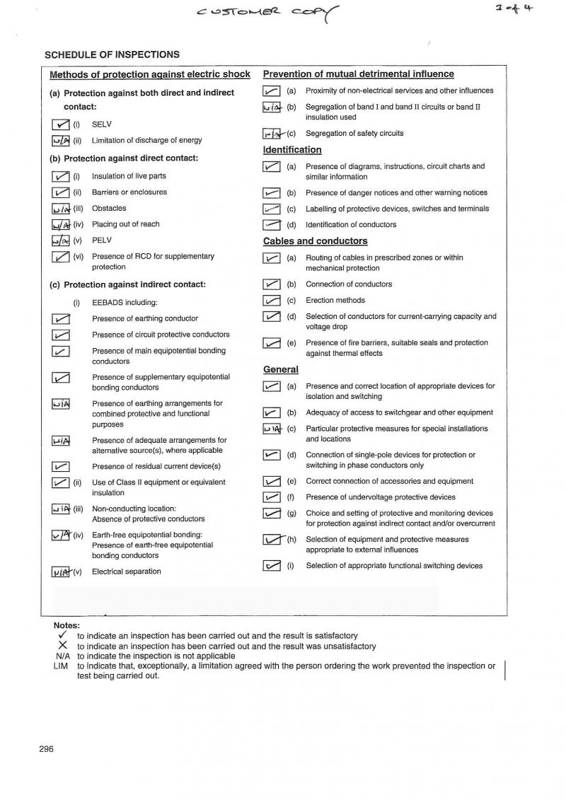

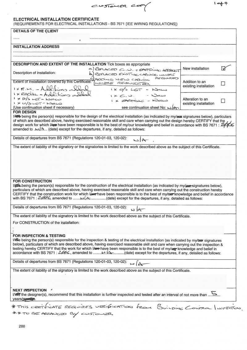

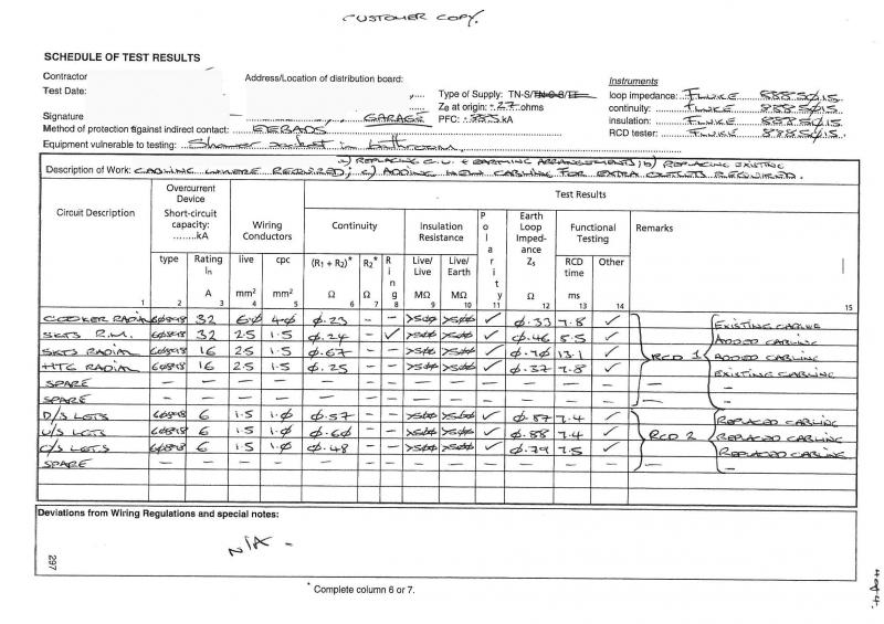

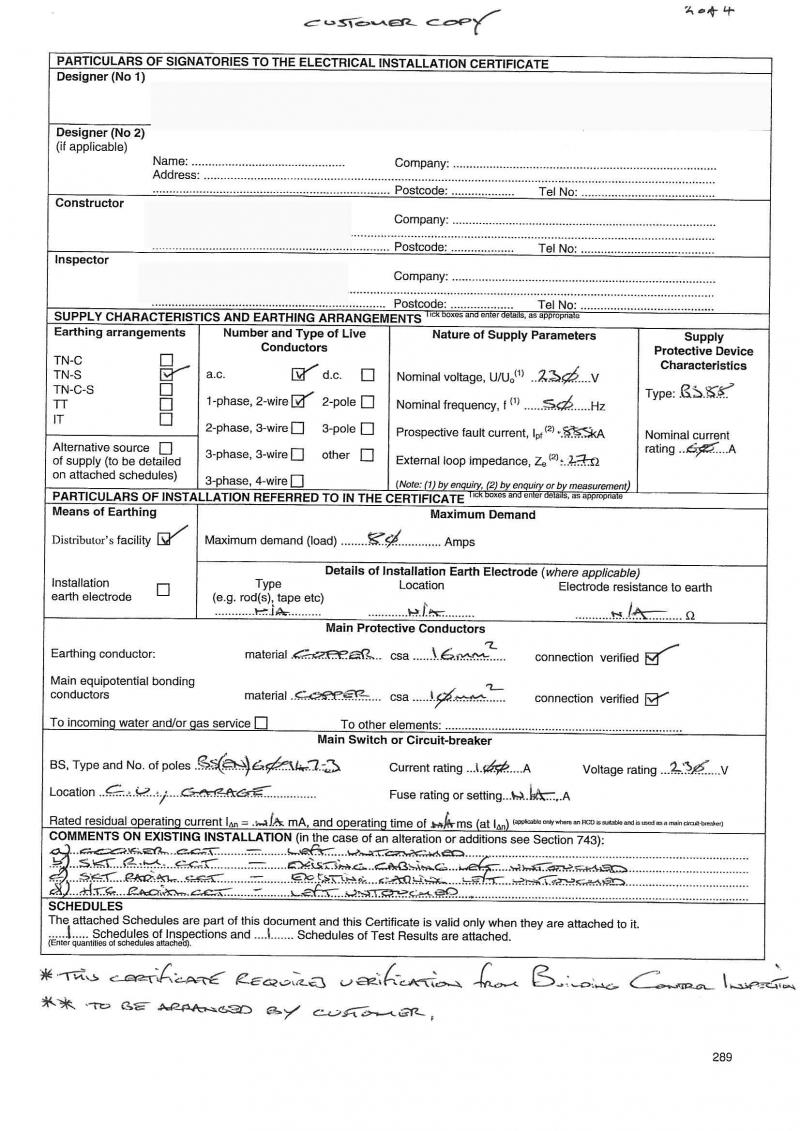

HI All,
Thanks again for your help with this, it is much appreciated.
I have attached the full detail of the correspondance to date- hopefully the images are clear enough, but if some details are needed and obscure I can clearly provide them
Does this help shed some light on a possible way forward?
Kind regards,
djb

"Inspection" report from LABC contractors
Cert P1
Cert P2
Cert P3
Cert P4
Its a bit difficult to see all the details and test results, but it does seem that the LABC are only complaining about the EIC page 1 entry refering to BS7671 2006.
Zs results seem to comply as do Insulation resistance
Maybe if he had entered BS7671 2008 on the certificate they would be happy
The short circuit capicity for over current device on page 4 is missing - but they haven't mentioned that in their letter.
It looks like it has been produced by someone who is not a currently practicing electrician. Maybe a spark out of retirement. I think that has what has raised questions at the labc. The fact that the cert is on a standard form doc (nothing wrong with that) is unusual as most will put it on a carbonised one from the local wholesalers or the one issued by thier approval body be NICIEC or any of the others.
If he had put 2008 I believe it would have been acceptable. But now they are asking for his qualifications so as long as he has some ( which I a sure he has) then all he needs to do is produce another cert and send that with his quals copy certs and every thing should be ok I think.
Martin
As said above, he has put that he's installed IAW BS7671:2001 (2006) and the forms he's used are for 16th ed installs....
Download the 17th ed forms from
http://www.theiet.org/publishing/wiring-regulations/forms/formspdf6.cfm?type=pdf
and get him to make them out again.. with the correct dates and ADS instead of EEBADS
If you send these off with a covering letter stating that he'd mistakenly filled out the wrong forms and put the wrong date in they may accept them without a problem...
Also get him to fill out the "domestic installer" forms rather than the "multiple contractor" form

Andprk- Two RCD's, one lighting, one sockets. (and only a shaver socket in the bathroom, and a ringmain spur to the boiler, no shower)
