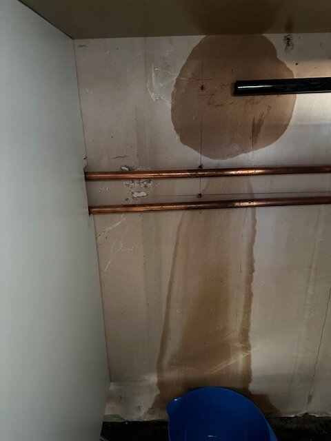

It was fit by a gas safe engineer, he fit everything and expected the builder to fit the condensate pipe to the waste pipe but he left before he fit it and just hid the issue behind my dishwasher.
I'm now trying to find out how to fit this condensate pipe to my waste pipe. Is it a DIY friendly job? If so, can anyone give me a guide? I am coming in very new to this so I have 0 idea of what I need to do.

Oh, that's interesting. I'll contact the installer again. Do you think I can expect further damage? The plaster it's been dripping on seems fine still
The installer Gas Safe ? - it's his duty to fully install the pipe to correct regs. The regulating body would be interested IF he doesn't finish the job ( @ no cost)

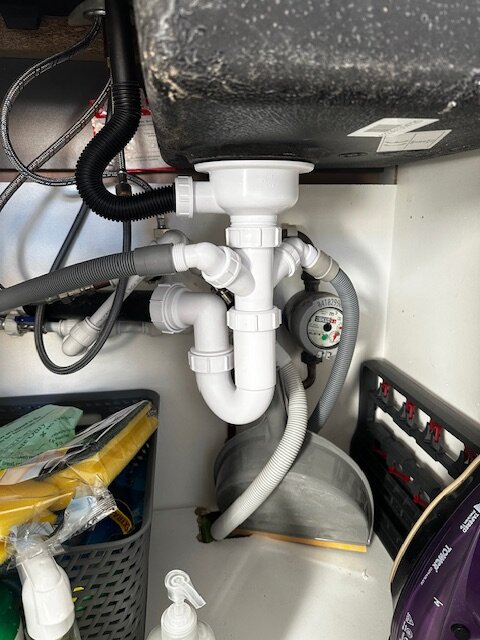

If you are able to do basic plumbing, you can connect it to the waste pipe that your sink drains into. This would be much better than a bucket or an open ended pipe. Do not let it drip into the house.

Best part of a year although it must only started leaking after I moved in (2 weeks ago) as the puddle only appeared last week which was when I noticed the leak

The issue, looking at the pics, is there is very space under the sink to actually plumb that in. That and both appliance inlets are used so they can't be utilised. Would probably need a saddle clamp attached to the black waste pipe if there's space.
If that's been there for the best part of a year then that'll have been doing that every time the CH was on, anything up a 1L per hour.

Yeah, this house has been a nightmare for me. Is there anything I should look out for damage wise in regards to corrosive water damage? As I say I can't see anything obvious

Based on what you say, I very much doubt that it will have harmed anything.
