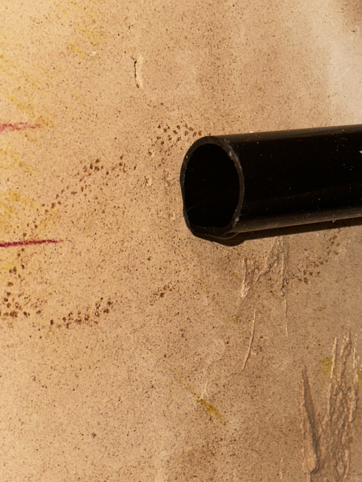

Did he tell you where he ran the pipe to?
I cannot see any holes from the pipe fixing brackets . That said, you have only provided two images.
Can you take closer images of the end of the black pipe? I cannot see any evidence of anyone cutting the end of it.

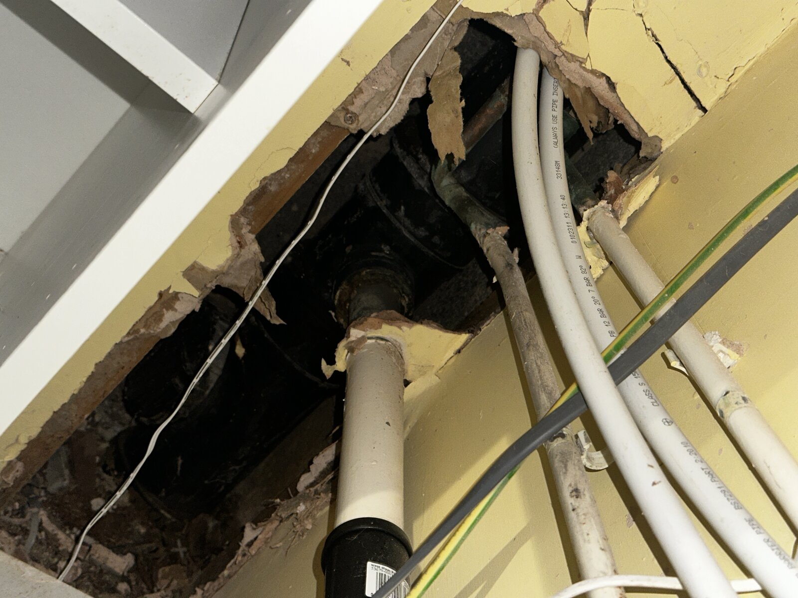

Just some more pictures,
Looks like all waste goes straight into the soil pipe, where would be the best place to T off?
Oh great, push fit, I really wish they would ban that stuff.

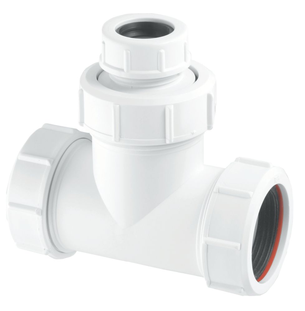

Easiest way would probably be to extend the 21.5mm with a solvent coupler, clipping as they went, through the cabinet wall(s) and then along to a section that has the space and fit one of these, again with suitable clipping
The condensate would then be connect into the saddle.
