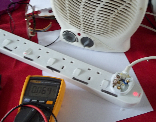

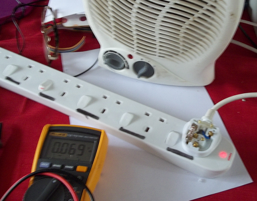

I measured the voltage difference between the caps of a 13 amp fuse when supplying a fan heater
1 kWatt load Vd = 0.034 V
2 kWatt load Vd = 0.073 V
Heat created in the fuse wire assuming 4 Amp current per kWatt load
W = V x I
1kW load-------0.034 Volts x 4 Amp = 0.136 Watt
2 kW load-------0.073 Volts x 8 Amp = 0.536 Watt
Estimating that a 3 kW load will take 12 amps and produce a Vd across the fuse of 0.102 Volt ( 3 times 0.034 )
3 kW load--------0.102 Volts x 12 Amp = 1.22 Watt
The voltage measurement was from the caps of the fuse and therefore did not include any voltage drops ( heat sources ) created by poor contact between fuse holder and the fuse caps or between plug pins and socket receptacles or cable and terminals.

If I understand you correctly,
"3 kW load--------0.102 Volts x 12 Amp = 1.22 Watt
A fuse in good order can release about as much heat as a 1W lightbulb
Which is trivial.
