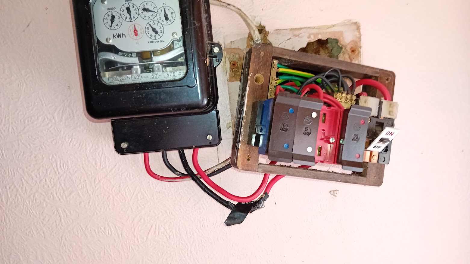

Any doubts about this being a C1?
Tenant has been there since 2018 and Agent arranged EICR, landlord blames tenant, tenant showed me the Estate Agents papers from 2018 where that can just be seen in one of their pics and of course a line saying the electrics needs updating. It's a 10mm² T&E from the cutout

Presuming that is how it was found, and that you hadn't removed the cover before the photograph, then yes thats most certainly a C1, it also would get heavy duty tape to cover over exposed live parts and unsheathed cores and an electrical danger notice.

Yes that is exactly as I found it and appears to be the same in the Estate Agends sales literature dated 2018.

For now I've screwed a large ABS adaptable box lid over the whole thing to improve the IP rating

I've informed the energy supplier.

Wylex isolator rated 60 amp, so 10 mm² is not really a problem. Covers missing clearly is a problem.
Assuming fuse is ≤60A but the T&E wires are unsheathed and earth is undersize.
The problem with a code C1, is one should not leave without making safe, the question is how would you make it safe if that involves pulling the DNO fuse? Or removing the occupants from the premises? Who pays for the alternative accommodation while the fault is corrected.

A contractor does not have any rights to do anything without permission from the owner or user therefore advise in writing and in the strongest terms and inform the DNO and other relevant orginisations

It is in this case clear, one can't simply write out the EICR with code C1's, it needs to be made safe, would a text to the Estate Agents, followed of course by a phone call, be enough? Interesting to hear how the situation was dealt with?

There can't have possibly been an EICR then or since or if there was it wasn't acted upon.

I have had the deep lid from a gewiss adaptable box in the car for a while, used as a 'car tidy' IE contains crap including offcuts when I work from the back of the car It's about 300x250x100mm. My 'make it safe' (against IP) has simply been to screw it to the wall to cover the fusebox. It means it can't be accessed for isolation for now pending proper repair. Now back in the hands of agents with before and after pics and a very quick report(~40 words).
I haven't seen the EICR, just told the CU C1 is the only fault and half expected to find a blank missing or similar. I have no idea what the missing fuse is for, all the lights and sockets work, gas cooker and combi, no sign of cooker point of electric shower, no outbuildings, just a very small 1 bed 1 reception bungalow. Whole building is only ~3.3x10m from googlemaps.
