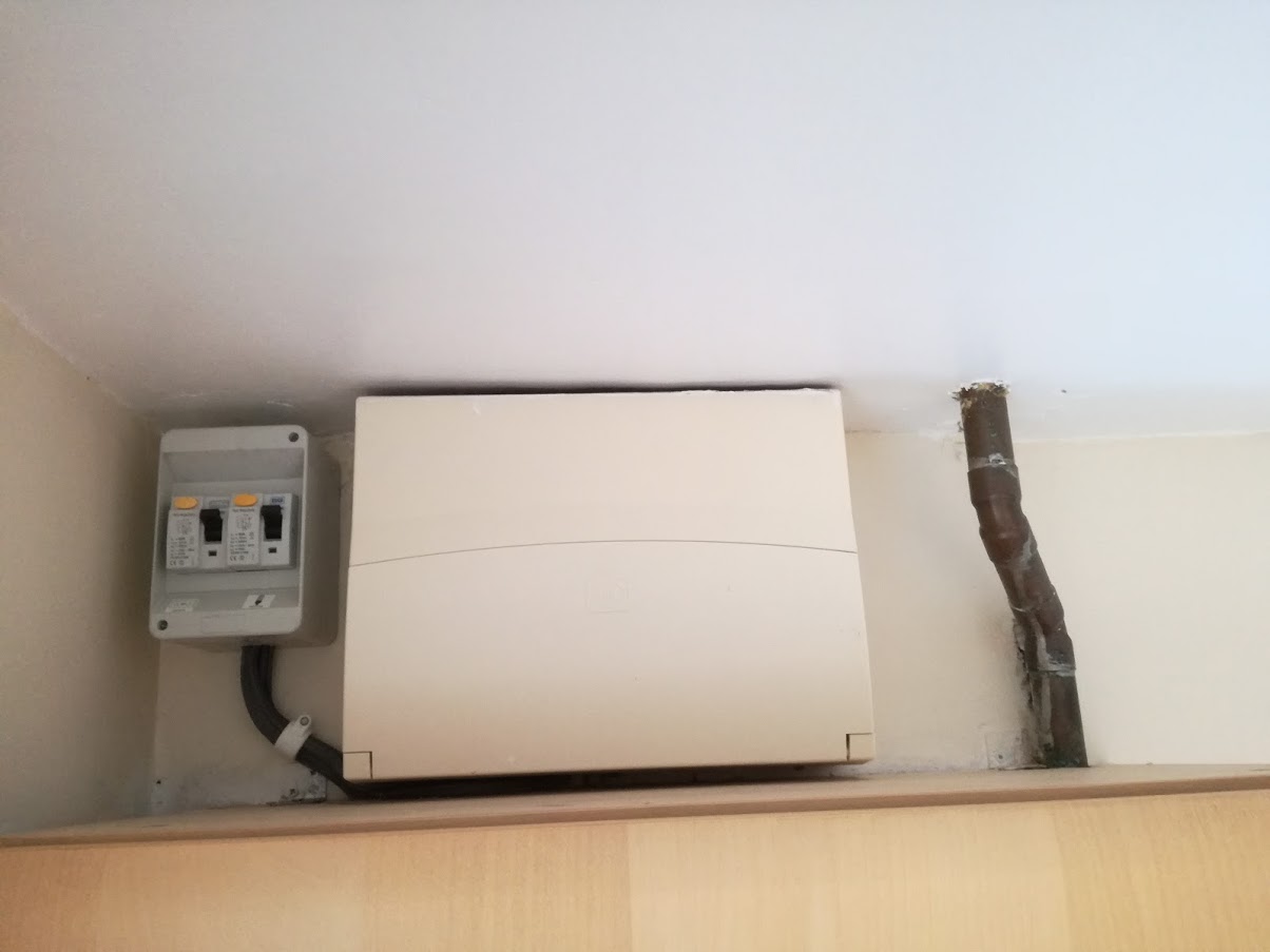

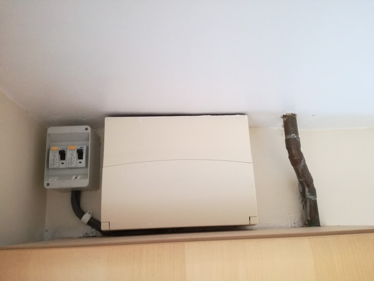

It is not a new installation but it is maintained and clean, I mean this is not an old wooden board with wires dangling (see photo).
I have a tenant since Sept, the agent who has full management since Sept as well never mentioned the state of the electrics as a mess.

From reading your EICR I would suggest that a replacement consumer unit would resolve virtually all of the observations listed.
Having seen your photograph it now renders the EICR null and void. It does not reflect your installation and can not be trusted to be accurate.
RF Lighting,
In the box, my husband says there are only Circuit Breakers.
The RCBO outside is for the lights of the bathroom that has been completely renewed this summer.
The separate enclosure contains two RCDs and appears to be labelled as sockets and lights although the picture is a little hazy when zoomed in.
There is no mention of any RCD protection at all in your EICR nor any test results for them so the report clearly does not accurately represent the true condition of your installation. If they got this obvious thing wrong, what else may be wrong in the report?
Quite so - and not only does the report clearly indicate that there were no RCDs, but one assumes that (in the absence of specific details) many of the observations coded as C2 relate to an alleged absence of any RCD protection.
It's so seemingly bizarre (even if one allows for possible incompetence) that I can't help but wonder whether the report provided actually relates to the OP's installation!
