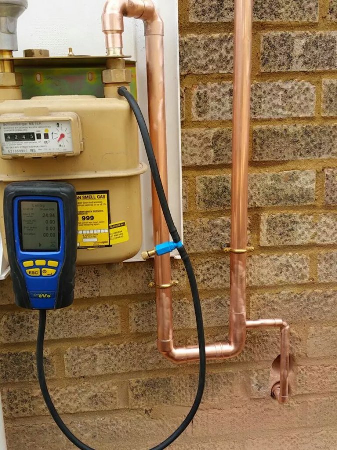

Can these pipes be moved back?

The heating engineer has been in touch and said the following-
http://www.tectite.co.uk/En/whyTectite we use these on Worcester Bosch, Vaillant and Glow Worm installations as these manufacturers have allows use of tectite on there installations as it reduces the risk of fire and unsightly solder marks.
The heating engineer has also said-
the installation of gas lines States that compressions are acceptable unless they are inaccessible. Most engineers including myself favour solder fittings but that is a matter of preference but is not a regulation in the instance of your installation my blow torch was faulty but compressions are allowed. You will see that the 22mm gas line is sleeved with a piece of 28mm copper which has been sealed with silicon as the regulation states. I was going to seal up the flue with a fire cement upon return. The certificate will all be completed once all works are completed. If there are anymore issues I would happily rectify but with regards to the gas line no regulations have been breeched as you can see in the following http://www.legislation.gov.uk/uksi/1998/2451/made
Apart from incorrect clipping of the gas pipe of course! How he can say solder fittings look unsightly after leaving you with that pipe work I'll never know. The blokes clearly clueless ! You should ask him did he get a 2 year old child to silicone up the gas pipe!
Besides, regs say you're supposed to seal the inside with a non setting mastic. Not empty a tube of silicone everywhere outside!!
The guy who fitted it is a cowboy, end of.

Does this look unsightly? (holes subsequently made good)
