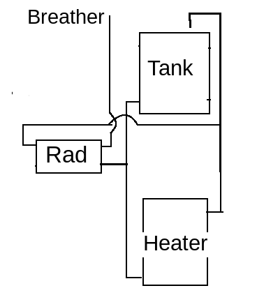

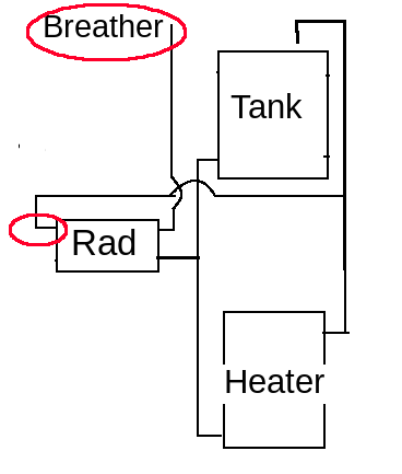

I have now updated my hot water only system. By modifying it by
1. adding a breather pipe out of the top of the radiator
2. moving the out let pipe of the radiator so it is at the top of the radiator for better absorbshon (have i got this the right way round?)
WTF is the radiator breather going to achieve?
The flow/return to that rad are now correct (remember flow pipe should be slightly uphill to the rad, return should be slightly downhill from the rad)
