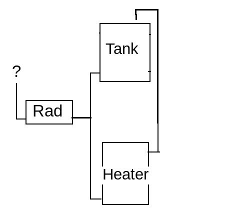

But I still dont get the principle for the need of the radiator. But can this be a standard house hold radiator mounted to the floor, heating the room doing its job as normal or must it be a gravity feed one as the in said diagram
The heat loss radiator has to be there to maintain the thermosyphon (so that even if power is off there is still a temperature difference between flow and return so water will continue to circulate and remove heat from the woodburner).
If you can position the heat loss rad so it can perform its gravity flow job and usefully warm a room then happy days (bathroom or landing is favourite, you wouldn't want it in a bedroom).
And no you cannot put a TRV or any other sort of valve on it.
So it has to be gravity feed then. So using a radiator upstairs will do the job? why not bedroom

Because that rad will be emitting heat while the woodburner is hot and there's no other thermal load on the system. If you want to put it in a bedroom then carry on but since you cannot switch the rad off you may end up with a very hot room.
Oh i see! it must be in circulation all the time then for it to do its job of safety. Must the radiator be placed in the middle between the tank and the boiler in the 2 diagrams I drew?
Yes. And the tank needs to be open (as in open vent system) and be full (well half full) of water- detail not shown on the generic drawing is a mains cold water supply to a metal ball valve in the tank and an overflow from the tank (usually through the eaves and into a gutter - don't let it just drip onto the pavement cos under fault conditions the tank might be boiling.
Pipe from the TOP of your burner wants to go up and over the f & e tank- that is the vent, the top of the 180 wants to be at least 500mm above tank water level.
You can tee off that pipe and connect to the TOP of your heatloss rad- the T must rise towards the rad
Pipe from the BOTTOM of your burner wants to fit to the bottom of the f & e tank. You can tee off that pipe and connect to the diagonal BOTTOM of the heat loss rad- the T ideally will fall from rad to pipe.
So if our header radiator needs venting then it will require 3 holes to it, water in and out and a vent right? or a ball instead
Like this? so what about the out put of the rad?
Surely you connect both connections to the rad to both connections to the heater, teeing off from one of them to go to the header tank to act as the fill/expansion pipe?
