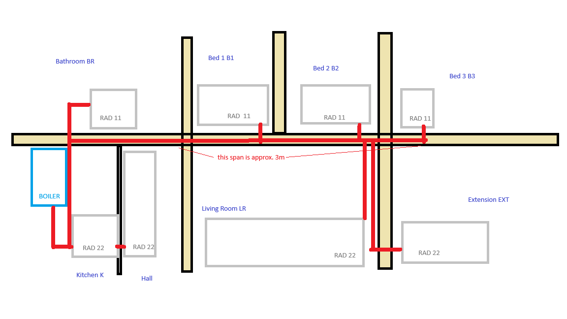

Are you sure the plumbing is correct, not allowing negative pressure somewhere, so drawing in air? A sketch would be useful

I’ll sketch something up soon and post it so you can see the layout.

Here's a paintmash. Yellow is walls. Red line is the piping route, representing both supply and return - they run in a pair each way.
This is simplified being 2D of course but the connections and their positions, ie which radiators they are between, is correct.
The worst rads are usually B3, LR, EXT. It can vary but these will suffer most.
I have the most success getting my fizzy air water from BR and B3, sometimes B1 a little.
Noisiest, clicking and ticking radiators are usually B1 B2 - will wake us up.
When I'm performing my bleeding I turn off all rads aside from LR and EXT, let them gurgle and waterfall, then ill turn on Bed3/Bath and get air from there.
