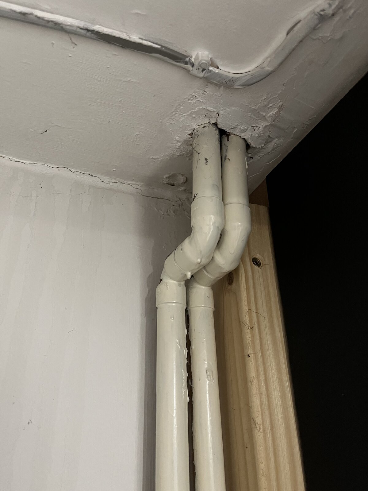

In the pipework up to bathroom there is a 90 degree bend to get it away from the joist as it goes into ceiling.. perhaps this is an issue.. it’s the only remaining oddity in the install but it’s just a normal angle.

that wouldn't trap air. Might be an old redundant loop somewhere. If you can hear the water trickling that is the sound of water falling through an air pocket so you should be able to find it roughly by that

So I’ve seen the entire pipework run and it’s all pretty by the numbers. No offshoots, no redundant parts.. in fact a few in the ago the ‘backbone’ was entirely upgraded to 22mm from 15mm. Previous person to mess with it had installed two shut off valves in line to BR. These were also removed.
When the system is running well now, it gets INSANELY hot, so the upgrade to pipework made a difference- but the degradation of the system and air issue is unchanged!
Between B2 and LR there used to be a weird ‘up and over’, upside down U shape over a joist. So I thought this might be the culprit. This was removed and the problem didn’t change!
