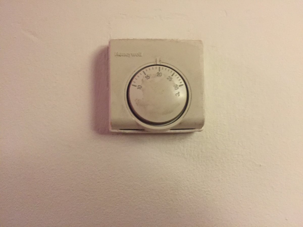

its a Vaillant EcoTec Plus 618 condensing boiler. Honeywell Thermostat (think it is a T6360 model) and a Honeywell programmer (ST9400C) as well.

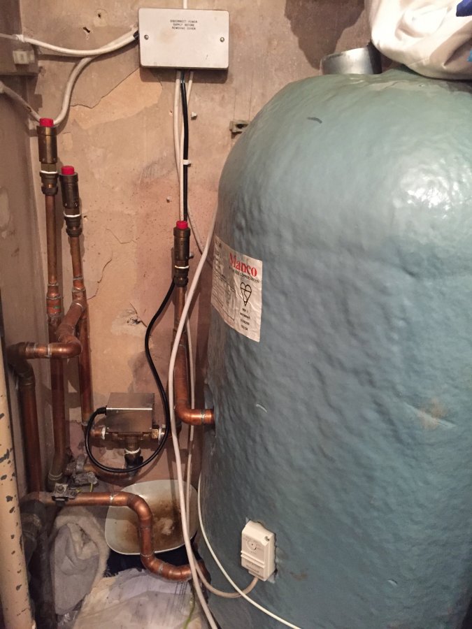

About 6 months ago In had not hot water from Taps so i went online and thought issue was with the valve that is connected to the programmer.

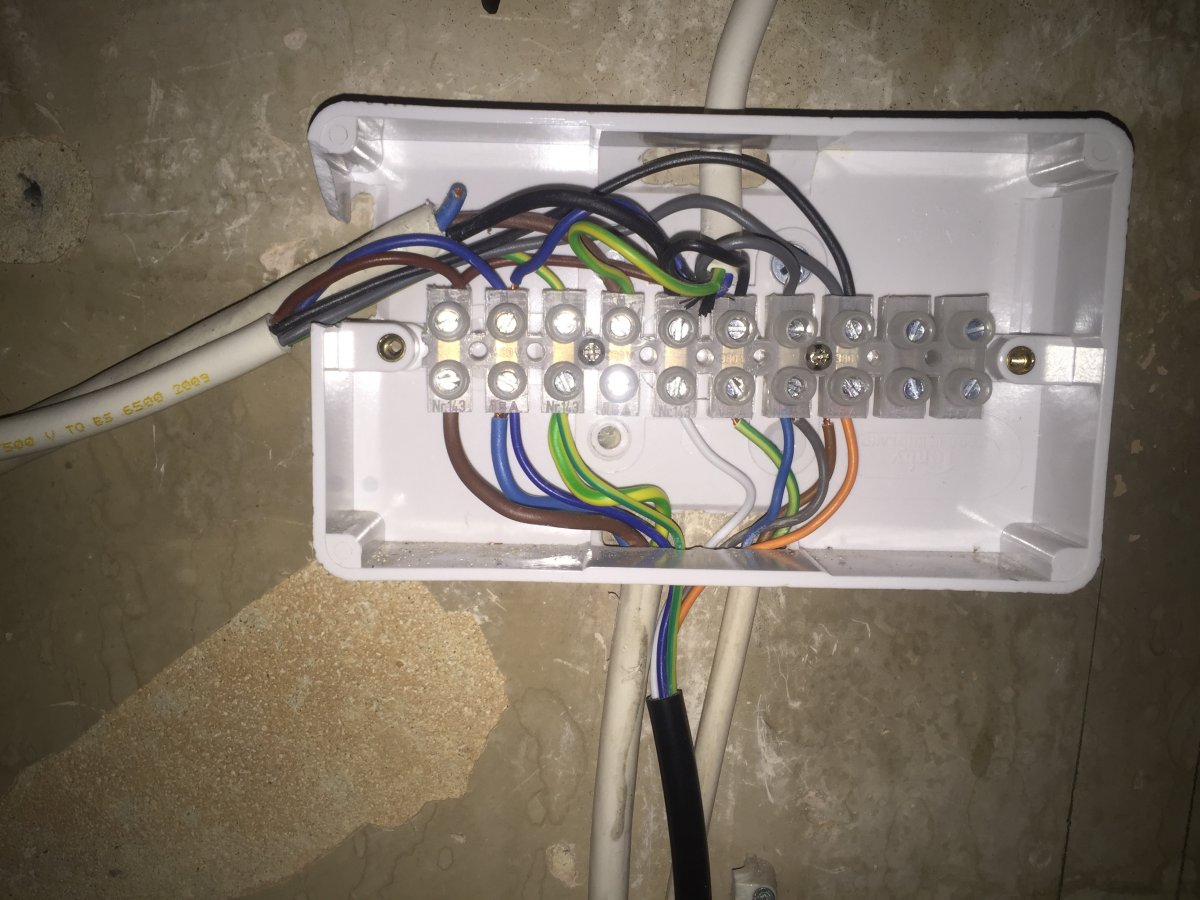

You can see from a picture how i reconnected the cables from the 3 port valve (the silver square box) to ST9400C programmer. However, that was not the problem anyway, the problem of no hot water that time was the ball valve in the tank.

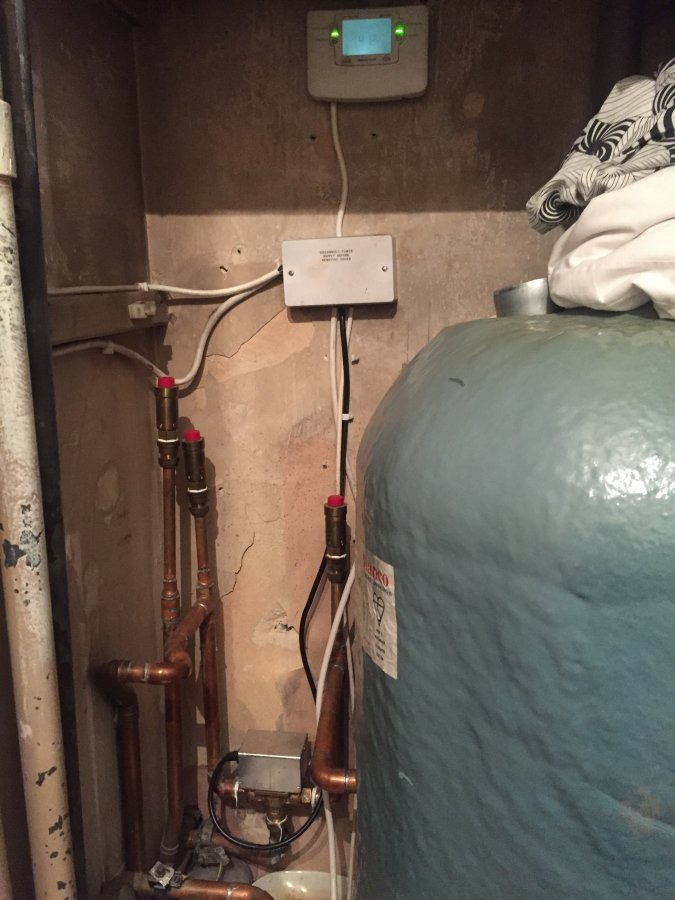

in the last six months basically once i had no hot water so researched and managed to change to a new 3 port valve and electrical connections that go with it very diligently making sure cables go exactly as they did before removing old one out. Hot water was still a issue even a plumber came and wiggled around the ballcock valve in water tank. Then couple of weeks ago had plumber come again he fixed the ballcock valve in water tank before that hto water coming in shower very rarely because waterf in tank not filling up.
As of now hot water is coming in shower but issue is central heating system is running not as it used to be. Oh also recently had some water leaking from the automatic air vent and had a expert come in who stopped the leaking from the air vent.

There's an couple of unidentified green cables in that wiring centre connected to strange things. You'd expect that green cables were only used for earth and, if you must use them, you'd hope to see some brown tape on it to show its carrying live.
The earth to your programmer is connected to something - potentially live but maybe not - it's unlabelled too! There's another earth going to your cylinder stat which seems connected to your programmer - a guess based on your pics.

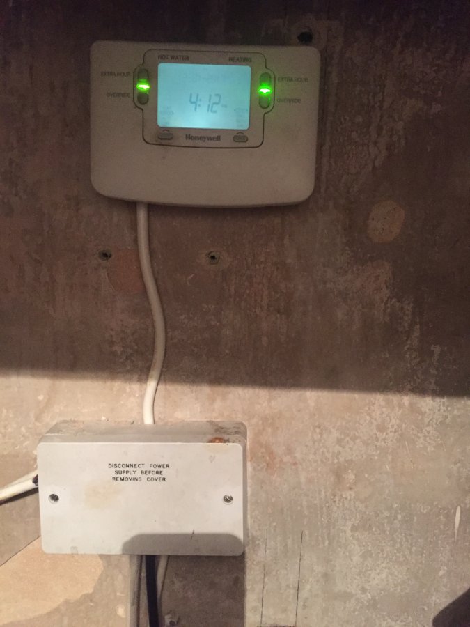

I tried to reset the programmer to default settings but no avail, still both HW and heating need to on to work. Can't switch heating on unless HW is also on.
Its going to be a wiring issue I reckon. I'll try map out your wiring if you can identify where each of those cables in the junction box go to (and say which one) Also if safe to do so, I might need to see the wiring in that programmer.

Have you got a pic of the programmer's wiring?

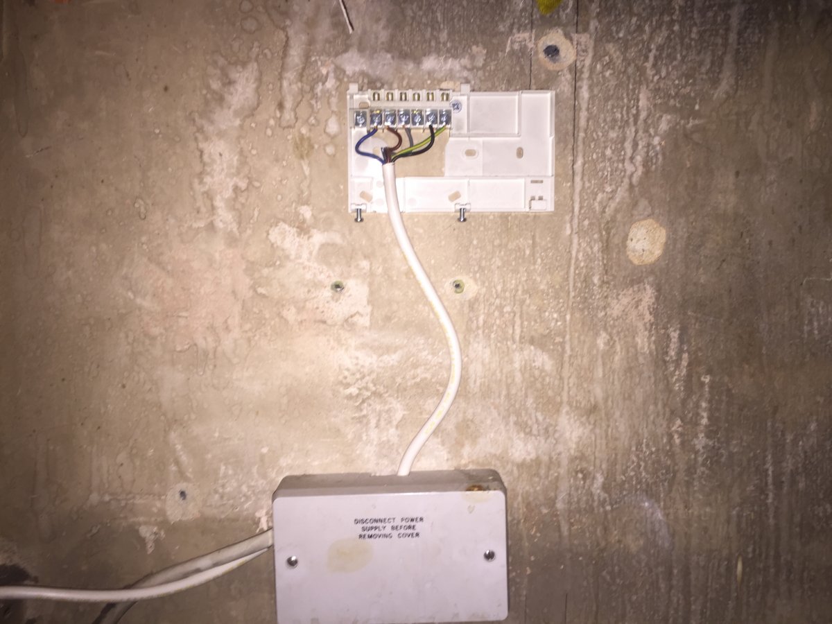

Can you turn all the power to the heating circuit and take a picture of the wiring behind the programmer?
I'd guess the green goes to heating ON, black goes to HW ON and grey is going to HW OFF (assuming the colours of the cables to the valves match the standard practice).
Yes I managed to take a picture of the wiring behind the programmer (pic now attached). Didn't play around with it just re-attached the unit back. But as I said before with pic attached before did re-wiring on the wiring unit when installing the new 3port motorised valve.
