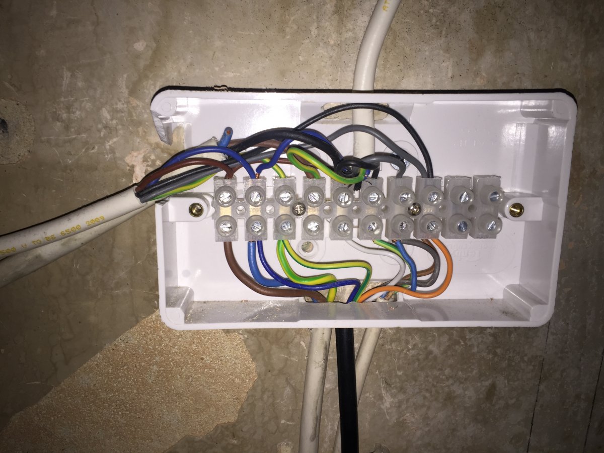

Final question should I open up the junction box and check for the orange wire ( which is the rightmost one, correct me if I am wrong) is the orange wire loose, fix it back and close the box.
Offcourse with power supply off from the main.
Yes I would check in particular that the grey and orange wires from the valve have a good electrical connection in the wiring centre. Either one of these could be the source of your problem.
Ok I think I have done it. Today I opened the wiring junction board that the valve connects to as well as the programmer and found the Grey/Blue wire very loose in fact not making connection to it slot. I have photo attached, it's fourth set of wire from the right side.
So after some fiddling as it was not easy putting it back to slot I managed to it and tighten the screw for that slot.
Then I put heating on from programmer, set room thermostat to 25 and saw the boiler coming on with the flame and heating icon, to double check I saw gas meter running as well.
Hot water was igniting the system anyway but I checked anyway and that was ok as well.
So now I have my central heating system back to as it was.
I like to thanks all for their opinions and especially to penguin16.
